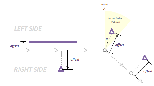

Offsets
Offset is the perpendicular distance of a point from the axis. It includes the following components:
  • Side: The left/right side is defined as if you are facing the direction of the axis. In the system, side is represented by the sign of the distance value. You specify whether a positive value represents the left or right side.
  • Offset: The offset from the referral measure point to the asset. It is always the perpendicular distance from the axis, except the direction is specified when the asset is in the inconclusive location.
    Note: The inconclusive location is a corner region in which the point is centered. The LRS uses the azimuth of the closest point to the asset in addition to the offset and measured values to handle this scenario.
  • Direction (A in the figure): The direction is used to locate an asset only when the asset is in the inconclusive location. For general cases, the direction is NULL.
