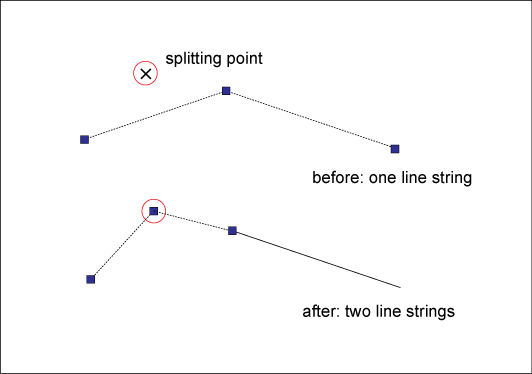

Line processing example: Split line creates two line features.
Line processing example: Add vertex inserts a new vertex. The lines move to the point.

Use Split to add a vertex and split an existing line into two line features that both inherit the attribute data of the existing feature. You can select an existing point or digitize any point in the drawing. |
Use Add Vertex to add a vertex to a line feature. Contrary to the split function there will be one line feature with a new vertex. You can select an existing point or digitize any point in the drawing. |
