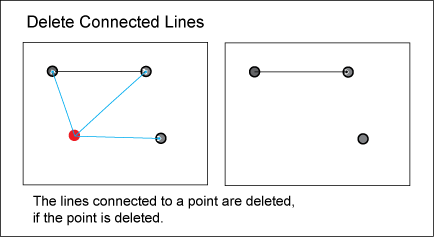

DeleteConnectedLines rule group
The DeleteConnectedLines rule group deletes lines connected to a point when the point is deleted.
  • DeleteConnectedLines_BD
  • DeleteConnectedLines_AD
The rule group applies to Utility point feature classes.
Name
Classification
Optional feature rule.
Location
Assembly: Autodesk.Map.IM.Utilities.dll
Classname: Autodesk.Map.IM.Utilities.FeatureRules.UtilityPointFeatureRules
Type
Client-side
Before Delete (BD).
Is System. Is Row.
Description
Deletes connected lines when a point is deleted.
Dependency
Member of a rule group.
Name
Classification
Location
Type
Client-side
After Delete (AD).
Is System. Is Row.
Description
Parameters
P1: AskUser. Default is YES.
Specifies whether the user is asked if the unneeded points should be deleted. If the parameter is NO, they are deleted without user interaction.
Dependency
