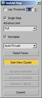

Unwrap_UVW Modifier - Regular (Unfold) Mapping
The following methods expose the Unfold Mapping workflow to MAXScript:
Unfold Mapping

<boolean><Unwrap_UVW>.RegularMapGetAutoWeld()
Returns the state of the "Use Threshold" checkbox.
Exposed via unwrap6 interface in 3ds Max 2012 and higher.
<void><Unwrap_UVW>.RegularMapSetAutoWeld <boolean>enable
Sets the state of the "Use Threshold" checkbox.
<float><Unwrap_UVW>.RegularMapGetAutoWeldThreshold()
Returns the auto-weld "Threshold" value.
<void><Unwrap_UVW>.RegularMapSetAutoWeldThreshold <float>threshold
Sets the auto-weld "Threshold" value. The Unfold Map dialog's UI will not be updated unless it is reopened.
<boolean><Unwrap_UVW>.RegularMapGetSingleStep()
Returns the state of the "Single Step" option.
<void><Unwrap_UVW>.RegularMapSetSingleStep <boolean>enable
Sets the state of the "Single Step" option to the boolean argument.
<integer><Unwrap_UVW>.RegularMapGetLimit()
Returns the selection index of the "Advance Limit" drop-down list option.
Possible values are:
1 - Full (default)
2 - Partial
3 - Always
<void><Unwrap_UVW>.RegularMapSetLimit <integer>limit
Sets the selection index of the "Advance Limit" drop-down list option to the specified integer. See above for supported values.
<boolean><Unwrap_UVW>.RegularMapGetNormalize()
Returns the state of the "Normalize" option.
<void><Unwrap_UVW>.RegularMapSetNormalize <boolean>enable
Sets the state of the "Normalize" option.
<integer><Unwrap_UVW>.RegularMapGetAutoFit()
Returns the selection of the "Auto Fit" drop-down list option.
1 - Auto Fit None
2 - Auto Fit Last (default)
3 - Auto Fit All
<void><Unwrap_UVW>.RegularMapSetAutoFit <integer>autofit
Sets the selection of the "Auto Fit" drop-down list option. See above for supported values.
<void><Unwrap_UVW>.RegularMapResetFaces()
Equivalent to pressing the "Reset Faces" button in the Unform Map dialog.
