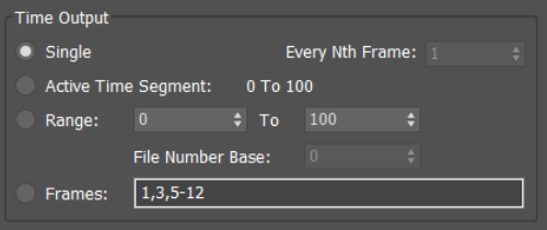

Time Output Group:
Changing the Render Setup dialog settings via MAXScript should be done with the actual Render Setup dialog in a closed state.
Leaving the dialog open will make the attempted MAXScript modifications non-sticky.
3ds Max System Global Variables:
rendTimeType -- integer
Get/set the type of time range to be rendered.
Possible values are:
1 -Single frame.
2 -Active time segment ( animationRange ).
3 -User specified Range.
4 -User specified Frame pickup string (for example "1,3,5-12"). See rendPickupFrames below.
rendNThFrame -- integer
Get/set the Every Nth Frame value. Minimum value is 1. Default is 1.
rendStart -- time
Get/set the Start Time value. Used when rendTimeType is set to 3.
rendEnd -- time
Get/set the End Time value. Used when rendTimeType is set to 3.
rendFileNumberBase -- integer
Get/set the File Number Base value.
rendPickupFrames -- string
Get/set the Frames string containing the user frames or sequences to render.

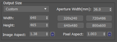

Output Size Group
renderWidth -- integer
Lets you get and set an Integer value that defines the output size width for the active renderer.
renderHeight -- integer
Lets you get and set an Integer value that defines the output size height for the active renderer.
renderPixelAspect -- float
Lets you get and set a Float value that defines the output pixel aspect for the active renderer.
Note that the Image Aspect is defined implicitly by the above values, though you can set the Image Aspect Ratio using rendImageAspectRation (below).
rendLockPixelAspectRatio -- boolean
Gets or sets the lock state of the Pixel Aspect setting in the Render Setup dialog box.
rendImageAspectRatio <float>
Get or set the Image Aspect Ratio for the current renderer. Setting this value adjusts the renderHeight value.
rendLockImageAspectRatio <boolean>
Gets or sets the lock state of the Image Aspect setting in the Render Setup dialog box.
Methods:
getRendApertureWidth()
Get the Aperture Width in millimeters for the current renderer.
getRendImageAspect()
Get the Image Aspect Ratio for the current renderer.
setRendApertureWidth <float>
Sets the Aperture Width in millimeters for the current renderer.

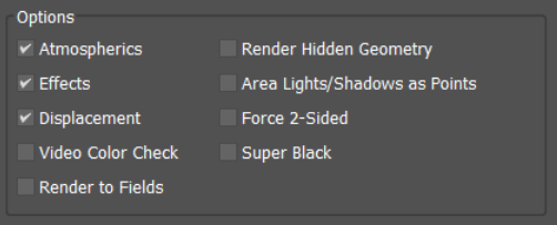

Options Group
rendAtmosphere -- boolean
Get/set the renderer's uses atmospheric effects flag. TRUE = on; FALSE = off
renderEffects -- boolean
Lets you get and set whether to perform Render Effects after a scene render.
A Boolean value - true if Render Effects are to be performed, false if not.
renderDisplacements -- boolean
Lets you get and set whether to perform displacement mapping during a render.
A Boolean value - true if displacement mapping is to be performed, false if not.
rendColorCheck -- boolean
Get/set the Video Color Check option.
rendFieldRender -- boolean
Get/set the Render To Fields options.
rendHidden -- boolean
Get/set the renderer's render hidden objects flag. TRUE = on; FALSE = off
rendSimplifyAreaLights -- boolean
When set to true , area lights will be examined and converted to point light sources when appropriate.
rendForce2Side -- boolean
Get/set the renderer's force two-sided flag. TRUE = on; FALSE = off
rendSuperBlack -- boolean
Get/set the renderer's super black flag. TRUE = on; FALSE = off
See also rendSuperBlackThresh

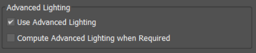

Advanced Lighting Group
These two options are exposed by properties of the Interface: RadiosityPreferences :
Properties:
RadiosityPreferences.useRadiosity
RadiosityPreferences.computeRadiosity

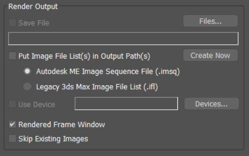

Render Output Group
rendSaveFile -- boolean
Get/set the state of the Save File option.
rendOutputFilename-- string
Lets you get and set a String value that defines the output file name for the active renderer.
It contains the corresponding value set in the Render Setup dialog.
If this global variable is set to "" then Save File check box in the Render Setup dialog will be unchecked.
rendUseDevice -- boolean
Get/set the state of the renderer's use device flag. TRUE = on; FALSE = off
rendShowVFB -- boolean
Get/set the state of the renderer's show virtual frame buffer flag. TRUE = on; FALSE = off
skipRenderedFrames -- boolean
Lets you get and set whether to skip rendered frames during a render.
A Boolean Value - true if rendered frames are to be skipped, false if not.
rendUseImgSeq -- boolean
Gets whether Save File is checked, and an output file specified.
rendImgSeqType: Integer
Gets whether Put Image File List(s) in Output Path(s) is checked, a file type is selected, and Create Now has been clicked. The returned integer is one of:
- 0 - Autodesk ME Image Sequence File (.imsq)
- 1 - Legacy 3ds max Image File List (.ifl)

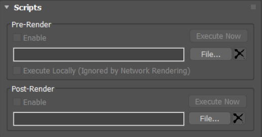

Scripts
usePreRendScript (system BooleanClass)
Get/set the state of the Pre-Render > Enable checkbox.
preRendScript (system String): ""
Get/set the file name of the Pre-Render script.
usePostRendScript (system BooleanClass)
Get/set the state of the Post-Render > Enable checkbox.
postRendScript (system String): ""
Get/set the file name of the Post-Render script.

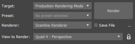

Render Presets
rendViewIndex -- integer
The index of the viewport to render when the Lock button is pressed ( rendUseActiveView is false )
The index numbers correspond to those used by the "viewport" functions, for example, viewport.activeViewport .
Available in 3ds Max 2009 and higher.
rendUseActiveView -- boolean
Get/set the Lock button state.
When set to false , the Lock button is pressed and the viewport specified by rendViewIndex will be rendered regardless of which viewport is active.
When set to true , the Lock button is depressed and the active viewport will be rendered, disregarding the selection in the drop-down list.
renderPresetMRUList -- array of string arrays
This property contains a list of render presets, matching the Render Dialog Preset dropdown list.
This is an array of items, where each item is an array of two sub-items. The first sub-item is the display name of the render preset, the second item is the filename of the corresponding render preset file.
Target Dropdown - this UI element is not exposed as a MAXScript function per se, but calls functions that define targets in the MacroScripts\Macro_RenderButtonActionItems.mcr script.
Also see the .renderDialogMode, .renderButtonText and .target parameters of the Renderers global struct, which are set by the target definitions.
