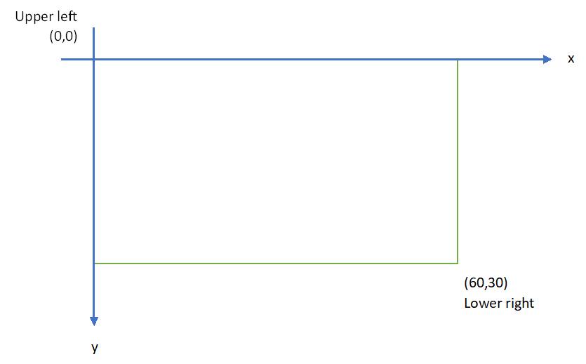

This will result in a box that looks like:
