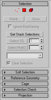

Properties
SelectionRollout
<Projection>.ignoreBackfacing BooleanClass default: false -- boolean; Ignore_Backfacing
Get/Set the state of the "Ignore Backfacing" checkbox.
<Projection>.smoothGroup Integer default: 1 -- integer; Smoothing_Group
Get/Set the "Select SG" value. This is the smoothing group number (1-32) to select by.
<Projection>.materialID Integer default: 1 -- integer; Material_ID
Get/Set the "Select MatID" value. This is the material ID to select by.
<Projection>.clearSelection BooleanClass default: true-- boolean; Clear_Selection
Get/Set the state of the "Clear Selection" checkbox. When checked, the previous selection will be cleared.
Related Methods:
For related methods, see Projection Modifier-Selection Rollout Methods

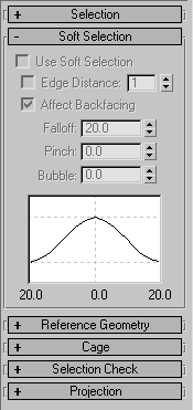

Soft SelectionRollout
<Projection>.useSoftSelection BooleanClass default: false-- boolean; Use_Soft_Selection
Get/Set the state of the "Use Soft Selection" checkbox.
<Projection>.softselUseEdgeDistance BooleanClass default: false-- boolean; Use_Edge_Distance
Get/Set the state of the "Edge Distance" checkbox.
<Projection>.softselEdgeDist Integer default: 1 -- integer; Edge_Distance
Get/Set the "Edge Distance" value as integer.
<Projection>.softselAffectBackfacing BooleanClass default: true-- boolean; Affect_Backfacing
Get/Set the state of the "Affect Backfacing" checkbox.
<Projection>.softselFalloff Float default:20.0 -- world units; Falloff
Get/Set the Soft Selection "Falloff" value.
<Projection>.softselPinch Floatdefault: 0.0 -- float; Pinch
Get/Set the Soft Selection "Pinch" value.
<Projection>.softselBubble Float default: 0.0 -- float; Bubble
Get/Set the Soft Selection "Bubble" value.

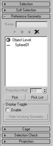

ReferenceGeometryRollout
<Projection>.geomNames ArrayParameter default: #() -- string array; Geometry_Selection_Names; Read-only
Contains geometry selection names. Read-only!
<Projection>.geomNodeIDs ArrayParameter default: #() -- int array; Node_ID; Read-only
Contains the geometry selection IDs. Read-only!
<Projection>.geomNodes ArrayParameter default: #() -- node array; Geometry_Nodes; Read-only
Contains the geometry selections nodes. Read-only!
<Projection>.IDs ArrayParameter default: #() -- int array; SO_IDs; Read-only
Contains the sub-object IDs. Read-only!
<Projection>.mapProportions ArrayParameter default: #() -- float array; Map_Proportions; Read-only
Contains an array of Map Proportions. Read-only!
<Projection>.projectionTypes ArrayParameter default: #() -- max object array; Projection_Types; Read-only
Contains an array of Projection Types. Read-only!
<Projection>.selLevels ArrayParameter default: #() -- int array; Selection_Levels; Read-only
Contains an array of Selection Levels. Read-only!
<Projection>.MapChannel Integer default: 1 -- integer; Map_Channel
<Projection>.geomNodeVisible ArrayParameter default: #() -- int array; Node_Visible
Contains an array of visibility flags.
Available in 3ds Max 8 and higher.
<Projection>.displayToggleEnable BooleanClass default: false -- boolean
Controls the state of the Enable checkbox in the Display Toggle group of controls.
<Projection>.displayToggleMode Integer default: 1 -- integer

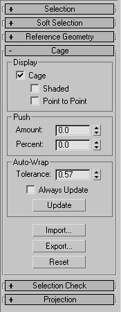

CageRollout
<Projection>.displayCage BooleanClass default: true -- boolean; Display_Cage
Get/Set the state of the "Cage" checkbox. When true, the cage will be displayed.
<Projection>.displayCageShaded BooleanClass default: false -- boolean; Display_Cage_Shaded
Get/Set the state of the "Shaded" checkbox. When true, the cage will be shaded.
<Projection>.displayCageOffset BooleanClass default: false -- boolean; Display_Cage_Offset
Get/Set the state of the "Point to Point" checkbox. When true, the projection vectors along the offset will be displayed.

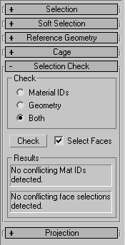

Selection CheckRollout
<Projection>.selectionCheckType Integer default: 2 --integer; Selection_Check_Type
Get/Set the selection of the Check radio buttons. Possible values are:
0 - Material ID
1 - Geometry
2 - Both (default)
<Projection>.selectionCheckSelFaces BooleanClass default: true -- boolean; Show_Selection_Check_Faces
Get/Set the state of the "Selected Faces" checkbox. When true, only selected faces will be checked.
Related Methods:
For related methods, see Projection Modifier-Selection Check Rollout Methods

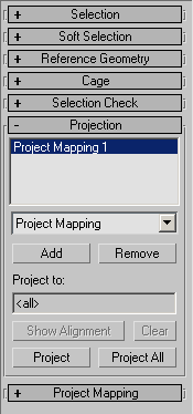

Projection Rollout
No properties exposed.
For related methods, see Projection Modifier-Projection Rollout Methods

Selection Rollout
<void>shrinkSelection()
Shrinks the selection. Corresponds to pressing the "Shrink" button in the Selection rollout.
<void>growSelection()
Grows the selection. Corresponds to pressing the "Grow" button in the Selection rollout.
<void>selectBySG <integer>sg
Selects by Smoothing Group. Corresponds to pressing the "Select SG" button in the Selection rollout.
<void>selectByMtlID <integer>id
Selects by Material ID. Corresponds to pressing the "Select MatID" button in the Selection rollout.
Geometry Selection Rollout
<boolean>isValidObject <node>node
Returns true if the node is a valid projection object.
<boolean>addObjectNode <node>node
Adds the given node to the Geometry Selection list.
<void>deleteAll()
Deletes all objects. Corresponds to pressing the "Delete All" icon.
<integer>numObjects()
Returns the number of objects in the Geometry Selection list.
<node>getObjectNode <index>objIndex
Returns the node corresponding to the indexed object on the Geometry Selection list.
<string>getObjectName <index>objIndex
Returns the name of the indexed object on the Geometry Selection list.
<enum>getObjectSelLevel <index>objIndex
getObjectSelLevel enums:{#object|#vertex|#face|#element)
Returns the selection level of the indexed object on the Geometry Selection list.
<boolean>getObjectSelFaces <node>node <index>objIndex <&bitArray>faces
faces is Out parameter
Returns the selected faces of the specified node and indexed objectinto the by-reference bitArray. The method itself returns true on success, false otherwise.
<integer>getObjectMtlIds <node>node <index>objIndex <&integer array>mtlIDs
mtlIDs is Out parameter
Returns the Material IDs of the specified node and indexed object into the by-reference Array of integers.
<void>deleteObjectNode <index>objIndex
Deletes the indexed object from the Geometry Selection list.
<integer>numGeomSels()
<string>getGeomSelName <index>selIndex
Returns the name of the indexed selection.
<enum>getGeomSelLevel <index>selIndex
getGeomSelLevel enums: {#object|#vertex|#face|#element)
Returns selection level of the the indexed selection.
<integer>numGeomSelNodes <index>selIndex
Returns the number of geometry selection nodes with the given selection index.
<node>getGeomSelNode <index>selIndex <index>nodeIndex
Returns the scene node corresponding to the indexed node and indexed selection.
<boolean>getGeomSelFaces <node>node <index>selIndex <&bitArray>faces
Returnsthe face selection of the given scene node and the indexed selection in the by-reference bitArray. The method itself returns true on success, false otherwise.
<integer>getGeomSelMtlIds <node>node <index>selIndex <&integer array>mtlIDs
Returns the Material IDs of the given scene node and the indexed selection in the by-reference Array of Integers.
<float>getGeomSelMapProportion <index>selIndex
Returns the Map Proportion value of the indexedgeometryselection.
<void>SetGeomSelMapProportion <index>selIndex <float>proportion
Sets the Map Proportion value of the indexedgeometryselection to the supplied float value.
<void>deleteGeomSel <index>selIndex
Deletes the indexed geometry selection.
<void>deleteGeomSelNode <index>selIndex <index>nodeIndex
Deletes the indexed node from the indexed geometry selection .
<float>getGeomSelFaceArea <node>node <index>selIndex
Returns the face area of the indexed geometry selection of the given node.
<void>setGeomSelNodesVisibility <boolean>visible
Sets the visibility of the current Geometry Selection node to the given boolean value. Corresponds to pressing the visibility icon in the Geometry Selection list.
<boolean>getGeomSelNodesVisibility()
Cage Rollout
<void>autowrapCage()
Performs a Cage Auto-Wrap. Corresponds to pressing the "Update" button in the Auto-Wrap group of controls.
<void>resetCage()
Resets the Cage. Corresponds to pressing the "Reset" button in the Auto-Wrap group of controls.
<void>pushCage <float>amount
Pushes the cage by the given amount. Corresponds to chaning the Amount value in the Push group of controls.
<boolean>importCage <node>importNode
Imports the cage from the specified node.Available in 3ds Max 2008and higher.
<boolean>exportCage <string>exportNodeName
Exports the cage as a new node with the given name.
Available in 3ds Max 2008 and higher.
<integer>checkDuplicateMatIDs <node>node <&bitArray>dupFaces
dupFaces is Out parameter
Performs a check for duplicated Material IDs and returns a bitarray in the by-reference argument containing the offending faces.
The method itself returns the number of offending faces as integer.
<integer>checkDuplicateSels <node>node <&bitArray>dupFaces
Performs a check for duplicated Selections and returns a bitarray in the by-reference argument containing the offending faces.
Projection Rollout
<integer>numProjectionTypes()
Returns the number of projections currently on the Projection list.
<void>removeProjectionType <index>ptIndex
Removes the indexed Projection Type from the Projection list.
<void>projectProjectionType <index>ptIndex
Performs the projection using the the indexed Projection Type from the Projection list. Similar to pressing the "Project" button.
<void>projectAll()
Projects all.Corresponds to pressing the "Project All" button.
<integer>numRegisteredProjectionTypes()
Returns the number of available Projection types.Currentlythere is only one type implemented.
<maxObject>getProjectionType <index>ptIndex
Returns the indexed Projection object.Currentlythere is only one type implemented :Project_Mapping : ReferenceTarget
<void>addRegisteredProjectionType <index>rptIndex
Adds a new projection of the indexed type to the Projection list.
<void>getRegisteredProjectionTypeClassID <index>rptIndex <&integerarray>classID
classID is Out parameter
Returns the classID of the indexed projection type into the by-reference variable.
