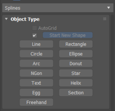

Circle : Shape
Circle - superclass: shape; super-superclass:node - classID: #(6553, 0)
Constructor
circle...
