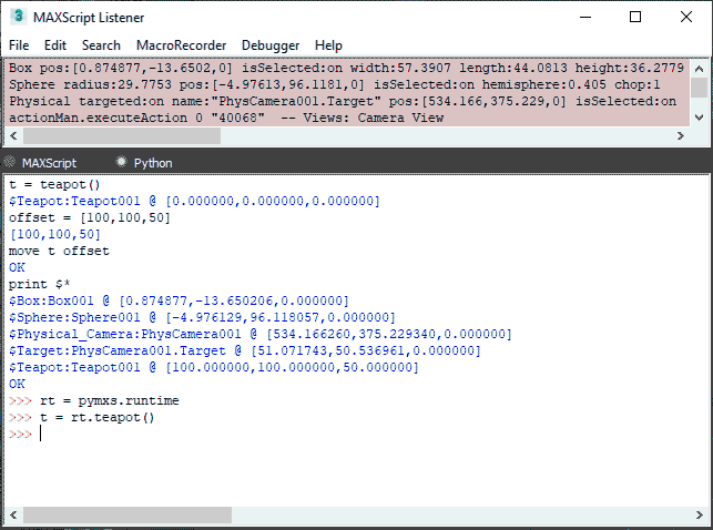

The Scripting Listener window is an interactive interpreter for the MAXScript language. MAXScript commands entered in this window are executed immediately when you press the ENTER key.
>>> prompt. For more information, see the 3ds Max Python Help.
The Listener window is appropriate for performing interactive work and developing small code fragments. Extended blocks of code should be developed in a Script Editor Window.
Each command you execute in Listener is actually an expression with a result which the Listener prints out after each execution.
All commands in MAXScript are expressions or function calls that can look like commands in other languages. The terms command and expression are synonymous in MAXScript.
You can enter any MAXScript expression or sub-expression in Listener for evaluation, and Listener prints out its result.
You can open only one instance of the Scripting Listener window at a time.

The Listener window is a resizable, modeless window. You can switch between it and 3ds Max as you work. The Listener retains any text it contains when it is closed and opened again.
If Auto Open Listener on Output is checked in Customize > Preferences > MAXScript, the Listener window opens automatically when a script outputs to it.
The Listener is divided into two panes: the top (pink) pane is the Macro Recorder pane, and the bottom (white) pane is the output pane.
When the Macro Recorder is enabled, everything recorded is displayed in the Macro Recorder pane.
The output of results from scripts are displayed in the output pane.
The output of code executed in the Macro Recorder pane is always directed to the output pane so as not to clutter the recordings.
Both panes allow you to cut-and-paste, drag-and-drop, edit, select, and execute code.
You can resize the panes by dragging on the split bar between them.
