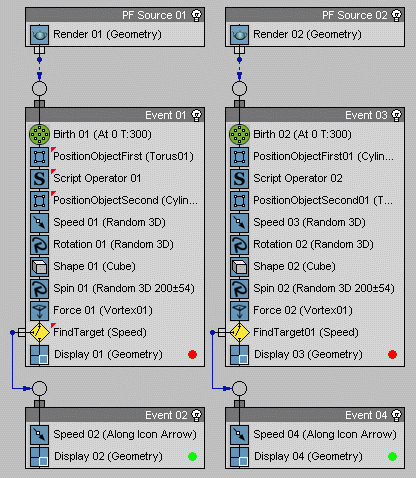

The script creates two geometry primitives and two PF_Sources with corresponding Actions and Events.
The geometry objects are used as volumes to be filled with particles. The initial positions of the particles are dumped to the particleVector channel. Using a Find_Target action, the particles find their way from the one volume to the other and switch places after swirling around.

-- Make copy of PF_Source and exchange Emitter objects
-- for Position_Object operators:
-- Clone the PF_Source and the two Emitters,
-- store the clones in a by-reference variable
maxOps.CloneNodes #(pf, ev1, ev2) newNodes:&dc
-- Get the PF_Source and Emitter clones
pfc = dc[1]
ev1c = dc[2]
ev2c = dc[3]
-- Get the current position of the Particle View...
x=y=1
pfc.GetPViewLocation &x &y
-- Reposition the two Events
ev1c.SetPViewLocation x (y+100)
ev2c.SetPViewLocation x (y+400)
-- Copy the emitter objects from the original Position_Objects
if $PositionObjectFirst01 != undefined then (
 $PositionObjectFirst01.Emitter_Objects = ev1_a4.Emitter_Objects
if $PositionObjectSecond01 != undefined then (
 $PositionObjectSecond01.Emitter_Objects = ev1_a2.Emitter_Objects
-- Bind the Find_Target Test output to the clone of the Second Event
if $FindTarget01 != undefined then (
 $FindTarget01.setNextActionList ev2c $FindTarget01
-- Switch to Modify Tab
max modify mode
-- Open Particle View to see what happened...
ParticleFlow.OpenParticleView()
