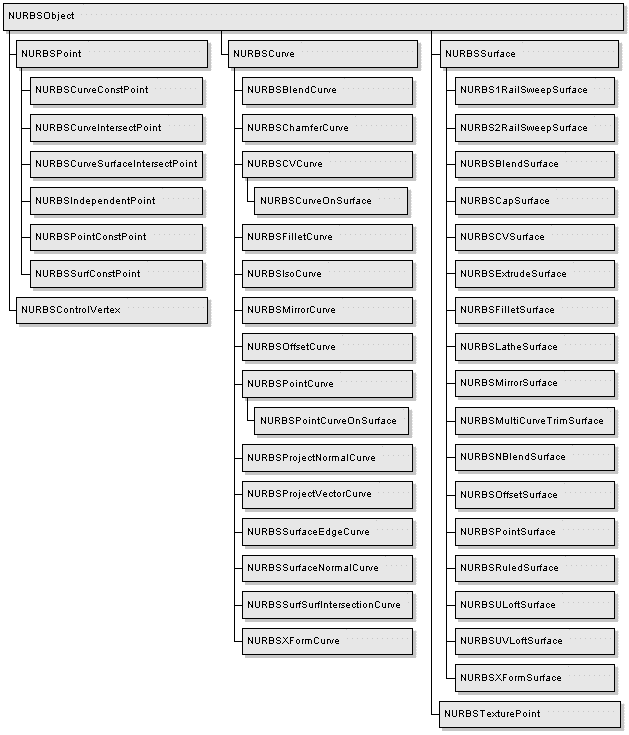

The diagram below shows the inheritance tree of the principal classes in the NURBS family. The base classes are shown at the top, and the inheritance hierarchy proceeds toward the bottom and to the right. NURBSObject is the main base class, with NURBSPoint, NURBSControlVertex, NURBSCurve , NURBSSurface, NURBSCVCurve, and NURBSPointCurve also functioning as base classes. Several additional classes are used with NURBS objects, but are not part of the NURBS hierarchy. These classes are the NURBSDisplay, NURBSSelection, NURBSSet, NURBSSurfaceApproximation, and NURBSTextureSurface classes.
NURBS Class Hierarchy
