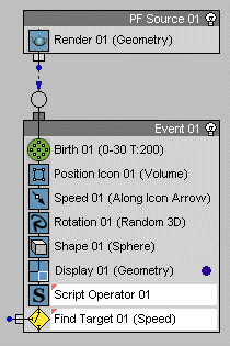

Description:
The following sample script assigns Vector values to the particleVector channel.
Can Be Used With:
Can be used in a Script_Operator to control the Target Point position of a Find_Target Test.
Effect:
Takes a scene geometry object, gets the position of its first vertex, adds a random offset to it, and assigns to the particleVector channel of all particles. In result, all particles stream towards the vertex because the Find_Target is set to read the particleVector channel and send all particles to the position in the channel:
