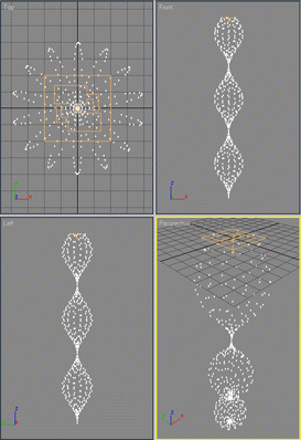

Effect:
The default script modifies particle speed and direction, causing particles to follow a bulb-shaped path:
EXAMPLE
