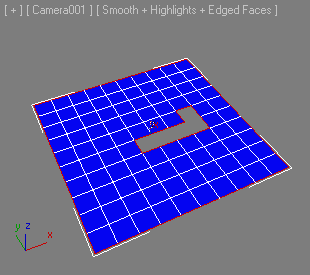

<boolean>PolyToolsSelect.FillHole ()
Fills an enclosed area. Select one sub-object element within the hole and fill. The selected part must stand free from the surrounding selection, so as an example the selected polygon cannot have any selected polygons right next to it.
| Sub-Object Level | Function |
| Polygon | Select one polygon within the hole and fill. |
| Edge | Select one edge within the hole and fill. |
| Vertex | Select one vertex within the hole and fill. |

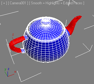

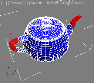

Select
<boolean>PolyToolsSelect.Tops <boolean>withinSel
Selects the tops of extruded parts in the model.
| Sub-Object Level | ShiftPressed = False | ShiftPressed = True |
| Polygon | Apply to select the tops of extruded polygons. | Select the tops of extruded polygons only within the current selection. |
| Edge | Apply to select the edge outline of the tops of extruded polygons. | Select the edge outline of the tops of extruded polygons only within the current selection. |
| Vertex | Apply to select the vertices of the tops of extruded polygons. | Select the vertices of the tops of extruded polygons only within the current selection. |

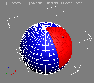

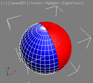

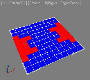

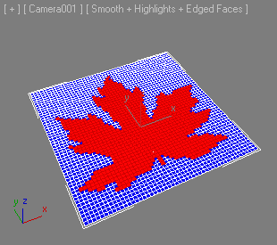

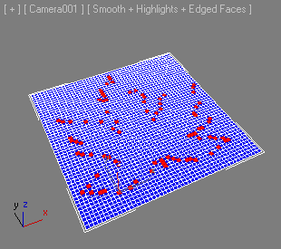

Selection - By Random
<boolean>PolyToolsSelect.Random <float>percent <integer>number <integer>type <boolean>withinSel
Selects random sub-object elements by percentage or absolute count.
The first argument is the percentage in the range of 0.0 to 100.0. It is used only when the third argument is set to 1.
The second argument is the absolute sub-object count to select. It is used only when the third argument is set to 0.
The third argument determines the selection mode: 0 = use absolute count and 1 = use percentage.
The fourth argument determines whether to select within all sub-objects or only the selected ones:
| Polygon | Select random polygons. | Select random polygons only within the current selection. |
| Edge | Select random edges. | Select random edges only within the current selection. |
| Vertex | Select random vertices. | Select random vertices only within the current selection. |
EXAMPLE:
thePlane = Plane widthsegs:20 lengthsegs:20 --create a plane convertTo thePlane Editable_Poly --convert to EPoly select thePlane --select the plane max modify mode --switch to modify panel subObjectLevel = 4 --switch to Polygon level PolyToolsSelect.Random 0.0 20 0 false --select 20 randompolygons subObjectLevel = 2 --switch toEdgelevel PolyToolsSelect.Random 50.0 0 1 false --select50% of the edges

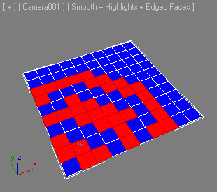

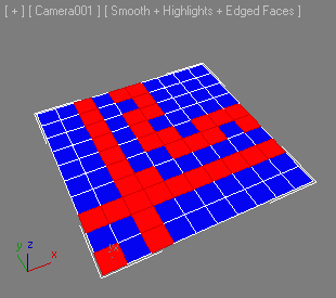

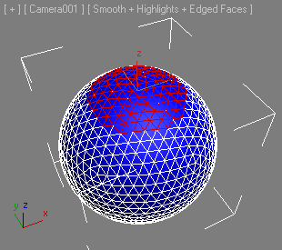

<boolean>PolyToolsSelect.RandomGrow ()
Grows the selection by selecting random sub-object elements outside the border of the selection area.
Returns true on success, false on failure.
<boolean>PolyToolsSelect.RandomShrink ()
Shrinks the selection by deselecting random sub-object elements on the border of the selection.

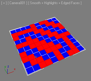

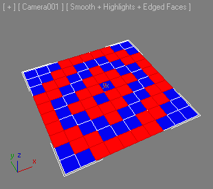

<boolean>PolyToolsSelect.Even <integer>skip <boolean>withinSel
Selects every Nth sub-object element, starting with the second and skipping the number of sub-objects specified by the first argument.
If the second argument is false, all sub-objects will be considered for selection.
If the second argument is true, only already selected sub-objects will be considered.
<boolean>PolyToolsSelect.Odd <integer>skip <boolean>withinSel
Selects every Nth sub-object element, starting with the first and skipping the number of sub-objects specified by the first argument.
If the second argument is true, only the selected sub-objects will be considered.

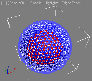

Selection - By Symmetry
<boolean>PolyToolsSelect.Symmetry <integer>axis
Selects subobject elements in the mirror axis of a symmetrical model.
The argument defines the axis as follows:
0 - X
1 - Y
2 - Z
The center of the object is determined by the object's pivot point.
| Polygon | Select polygons on one side of the model and apply to select polygons on the symmetrical side in the chosen axis. |
| Edge | Select edges on one side of the model and apply to select edges on the symmetrical side in the chosen axis. |
| Vertex | Select vertices on one side of the model and apply to select vertices on the symmetrical side in the chosen axis. |
EXAMPLE:

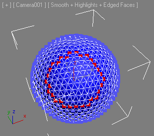

Selection - By Numeric
<boolean>PolyToolsSelect.NumericVertex <integer>edges <integer>type <boolean>withinSel
Selects vertices based on the number of edges specified as the first argument.
The second argument controls the type of comparison as follows:
1 - Equal
2 - Less than
3 - Greater than
The third argument controls whether only vertices within the current vertex selection must be tested (true) or whether all vertices in the object must be used (false).

<boolean>PolyToolsSelect.NumericEdge <boolean>withinSel
Selects edges that have only one adjacent polygon ("open edges").
The first argument controls whether only edges within the current edge selection must be tested (true) or whether all edges in the object must be used (false).
EXAMPLE:
p = Plane widthsegs:10 lengthsegs:10 wirecolor:blue --create a plane convertTo p Editable_Poly --convert to EPoly select p --select the plane max modify mode --switch to modify panel PolyOp.deleteFaces p #{45..48,58} --delete some faces to add open edges subObjectLevel = 2 --switch toEdgelevel PolyToolsSelect.NumericEdge false --select open edges

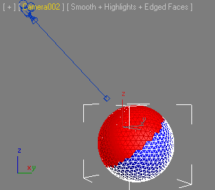

Selection - By Half
<boolean>PolyToolsSelect.Half <integer>axis <boolean>invert <boolean>withinSel
Selects half of the sub-object elements at the current Sub-Object Level.
The first argument specifies the axis as follows:
1 - X
2 - Y
3 - Z
The second argument controls whether the positive side of the object (true) or the negative side of the object (false) will be selected.
The third argument controls whether to use the whole object (false) or only the current selection (true).
EXAMPLE:
--Step 1: s = sphere radius:12 segs:40 wirecolor:blue convertTo s Editable_Poly --convert to EPoly select s --select the sphere max modify mode --switch to modify panel subObjectLevel = 4 --switch to facelevel --Step 2: Select positive (right) side along X using all faces PolyToolsSelect.Half 1 true false --Step 3: Select negative (front) side along Y using the existing selection PolyToolsSelect.Half 2 false true --Step 4:Select positive (top) side along Z using the existing selection PolyToolsSelect.Half 3 true true

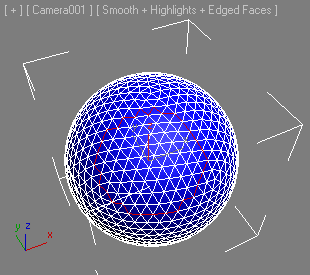

Selection - By Normal
<boolean>PolyToolsSelect.Normal <integer>axis <float>value <boolean>invert
Selects sub-object elements in the current Sub-Object Level based on normal vector.
The first argument defines the reference world axis as follows:
1 - World X
2 - World Y
3 - World Z
The second argument defines the angle threshold. Sub-objects with normals that define an angle with the reference world axis that is less than the threshold will be selected.
The third argument defines whether to select the sub-objects whose normals are below the threshold (false) or the ones whose normals are above the threshold (true).
EXAMPLE:

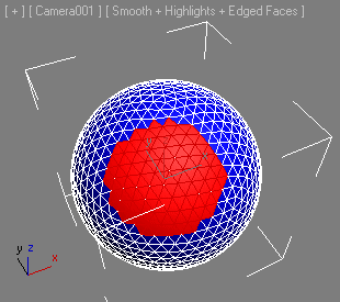

--Step 1: s = geosphere radius:12 segs:10 wirecolor:blue pos:[0,0,-5] convertTo s Editable_Poly --convert to EPoly select s--select the geosphere max modify mode --switch to modify panel subObjectLevel = 1 --switch to Vertex level PolyToolsSelect.Normal 3 15 false --select vertices within 15 degrees to +Z --Step2: subObjectLevel = 2 --switch to Edge level PolyToolsSelect.Normal 3 15 false --selectedgeswithin 15 degrees to +Z --Step3: subObjectLevel = 4 --switch to Face level PolyToolsSelect.Normal 3 15 false --select faces within 15 degrees to +Z --Step4: PolyToolsSelect.Normal 3 15 true --selectfaces outside of15 degrees to +Z

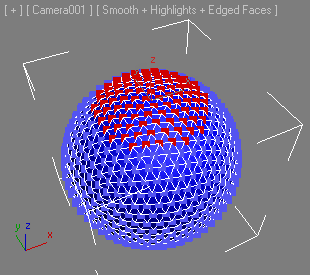

Selection - By Perspective
<boolean>PolyToolsSelect.Perspective <float>value <boolean>outline
Selects sub-object elements at the current Sub-Object Level whose normals are within the given threshold to the current view's Z axis.
The first argument defines the angle threshold.
The second argument controls whether all sub-objects within the Threshold must be selected (false) or only the ones adjacent to the outline of the selection (true).
EXAMPLE:
--Step 1: s = geosphere radius:12 segs:10 wirecolor:blue convertTo s Editable_Poly --convert to EPoly select s --select the geosphere max modify mode --switch to modify panel subObjectLevel = 1 --switch to Vertex level PolyToolsSelect.Perspective 30 false --Step 2: PolyToolsSelect.Perspective 30 true
--Step 3: subObjectLevel = 2 --switch to Edge level PolyToolsSelect.Perspective 30 false --Step 4: PolyToolsSelect.Perspective 30 true
--Step 5: subObjectLevel = 4 --switch to Face level PolyToolsSelect.Perspective 30 false --Step 6: PolyToolsSelect.Perspective 30 true

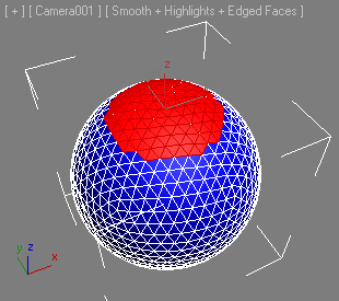

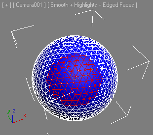

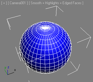

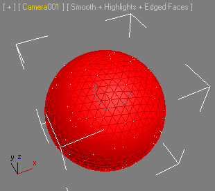

Selection - Grow From Perspective View
<boolean>PolyToolsSelect.PerspectiveGrow <float>value
Grows the sub-selection in the current view space by assuming the closest sub-object element to the viewer's position as 0 and growing the selection away from the viewer in world units.
EXAMPLE:
--Step 1: s = geosphere radius:12 segs:10 wirecolor:blue convertTo s Editable_Poly --convert to EPoly select s --select the geosphere max modify mode --switch to modify panel subObjectLevel = 4 --switch to Face level PolyToolsSelect.PerspectiveGrow 2
--Step 2: PolyToolsSelect.PerspectiveGrow 12
Because the Radius of the Geosphere is 12 units, selecting with a value of 12 selects approximately half of the sphere in the current view (Camera001 - left image).

--Step 1: t = teapot radius:10 segs:10 wirecolor:blue convertTo t Editable_Poly --convert to EPoly select t --select the teapot max modify mode --switch to modify panel subObjectLevel = 4 --switch to Face level PolyToolsSelect.Distance 70.0 --and select using 70% --Step2: PolyToolsSelect.Distance 60.0 -- select using60%
--Step 3: s.pivot = [0,0,5] --move pivot up by half the radius resetxform s --reset XForm collapseStack s --and collapse the stack subObjectLevel = 4 --switch toFacelevel PolyToolsSelect.Distance 70.0 --and select again using 70% --Step 4: PolyToolsSelect.Distance 60.0

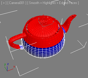

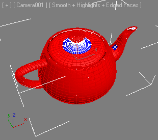

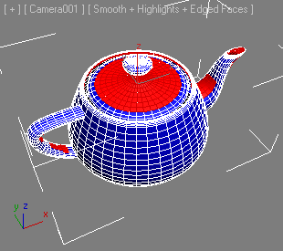

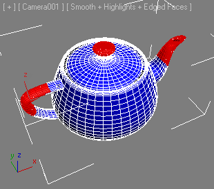

Selection - By Surface
<boolean>PolyToolsSelect.ConvexConcave <float>value <integer>isConcave
Selects sub-objects in the current Sub-Object Level based on a convexity/concavity threshold.
The first argument is the threshold value.
The second argument is the index of the Concave/Convex flyout in the UI as follows:
1 - Concave
2 - Convex
Returns true on success, false on failure. For example, if not in a valid sub-object mode.
EXAMPLE:
--Step 1: t = teapot radius:10 segs:10 wirecolor:blue convertTo t Editable_Poly --convert to EPoly select t --select theteapot max modify mode --switch to modify panel subObjectLevel = 4 --switch to Facelevel PolyToolsSelect.ConvexConcave 0.05 1 --Select Concave Faces --Step 2: PolyToolsSelect.ConvexConcave 0.001 2 --Select Convex Faces

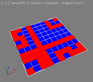

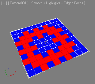

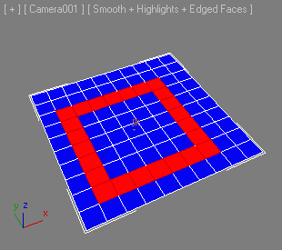

Selection - Patterns
<boolean>PolyToolsSelect.Pattern1 <integer>times
Applies Selection Pattern 1 for the specified number of times.
EXAMPLE:
--Step 1: p = Plane widthsegs:10 lengthsegs:10 wirecolor:blue --create a plane convertTo p Editable_Poly --convert to EPoly select p --select the plane max modify mode --switch to modify panel subObjectLevel = 4 --switch to Face level PolyOp.SetFaceSelection p #{45} --select a central face --Step 2: PolyToolsSelect.Pattern1 1 --Step 3: PolyToolsSelect.Pattern1 1 --Step 4: PolyToolsSelect.Pattern1 1 --Step 5: PolyToolsSelect.Pattern1 1 --Step 6: PolyToolsSelect.Pattern1 1
Note that you can achieve the look seen on the above right screenshot by calling
PolyToolsSelect.Pattern1 5right after evaluating Step 1 to perform the iterations internally.

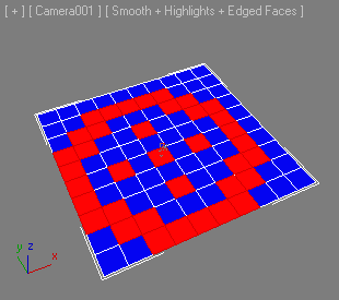

<boolean>PolyToolsSelect.Pattern2 <integer>times
Applies Selection Pattern 2 for the specified number of times.
EXAMPLE:
--Step 1: p = Plane widthsegs:10 lengthsegs:10 wirecolor:blue --create a plane convertTo p Editable_Poly --convert to EPoly select p --select the plane max modify mode --switch to modify panel subObjectLevel = 4 --switch to Face level PolyOp.SetFaceSelection p #{45} --select a central face --Step 2: PolyToolsSelect.Pattern2 1 --Step 3: PolyToolsSelect.Pattern2 1 --Step 4: PolyToolsSelect.Pattern2 1 --Step 5: PolyToolsSelect.Pattern2 1 --Step 6: PolyToolsSelect.Pattern2 1
<boolean>PolyToolsSelect.Pattern3 <integer>times
Applies Selection Pattern 3 the specified number of times.
EXAMPLE:
--Step 1: p = Plane widthsegs:10 lengthsegs:10 wirecolor:blue --create a plane convertTo p Editable_Poly --convert to EPoly select p --select the plane max modify mode --switch to modify panel subObjectLevel = 4 --switch toFacelevel PolyOp.SetFaceSelection p #{45} --select a central face --Step 2: PolyToolsSelect.Pattern3 1 --Step 3: PolyToolsSelect.Pattern3 1 --Step 4: PolyToolsSelect.Pattern3 1

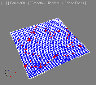

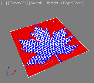

Selection - By Bitmap
<boolean>PolyToolsSelect.BitmapToSel <string>file <integer>mapchannel <point3>color
Selects sub-objects in the current Sub-Object Level based on a color from a bitmap file using a given mapping channel for the bitmap application.
The first argument is the file name of the bitmap.
The second argument is the mapping channel to use for the mapping of the bitmap onto the geometry.
The third argument is the color from the bitmap to use for selecting.
Internally, the color will be compared with a built-in threshold of +/- 8.0 (256/8= 32, so the threshold is 1/32 or about 3%).
EXAMPLE:
--Step 1: p = Plane widthsegs:50 lengthsegs:50 wirecolor:blue --create a plane convertTo p Editable_Poly --convert to EPoly select p --select the plane max modify mode --switch to modify panel subObjectLevel = 4 --switch to Edge level --Select faces where the bitmap color is pure white. PolyToolsSelect.BitmapToSel "ELMLEAF.TGA" 1 white --Step 2: Select faces where color is black. PolyToolsSelect.BitmapToSel "ELMLEAF.TGA" 1 black
--Step 3: PolyToolsSelect.BitmapToSel "ELMLEAF.TGA" 1 (white*0.97) --Step 4: PolyToolsSelect.BitmapToSel "ELMLEAF.TGA" 1 (white*0.96)
--Step 3: PolyToolsSelect.BitmapToSel "ELMLEAF.TGA" 1 (white*0.04) --Step 4: PolyToolsSelect.BitmapToSel "ELMLEAF.TGA" 1 (white*0.03)
