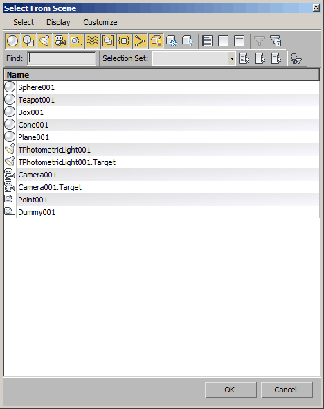

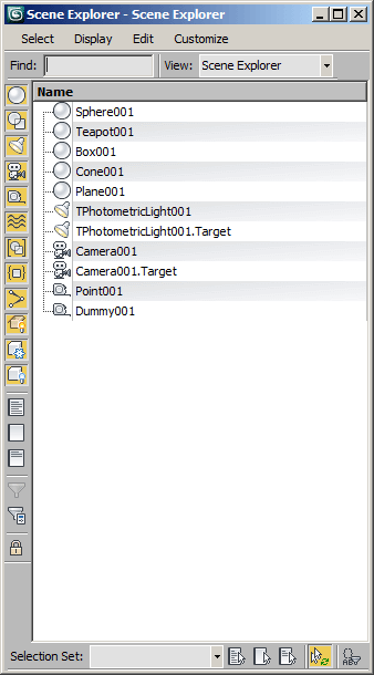

dotNetObject "MaxCustomControls.SceneExplorerControls.SceneExplorerDialog"
This dotNetObject implements the modeless Scene Explorer dialog form.
EXAMPLE
theFrm = dotNetObject "MaxCustomControls.SceneExplorerControls.SceneExplorerDialog" thePtr = DotNetObject "System.IntPtr" (windows.getMAXHWND()) theHwnd = (dotNetObject "System.Windows.Forms.NativeWindow").FromHandle thePtr theFrm.Show(theHwnd)
Constructors:
MaxCustomControls.SceneExplorerControls.SceneExplorerDialog() MaxCustomControls.SceneExplorerControls.SceneExplorerDialog <System.String>name
MaxCustomControls.SceneExplorerControls.SceneExplorerDialog <System.String>name <ExplorerFramework.DataFacade>dataFacade

dotNetObject "MaxCustomControls.SceneExplorerControls.ModalSceneExplorerDialog"
This dotNetObject implements the modal Scene Explorer dialog form. Note that it does not block the main 3ds Max thread when opened and requires event handlers to be registered to be fully functional (e.g. return a selected object).
EXAMPLE
theFrm = dotNetObject "MaxCustomControls.SceneExplorerControls.ModalSceneExplorerDialog" thePtr = DotNetObject "System.IntPtr" (windows.getMAXHWND()) theHwnd = DotNetObject "MaxCustomControls.Win32HandleWrapper" thePtr theFrm.Show(theHwnd)
Constructors:
MaxCustomControls.SceneExplorerControls.ModalSceneExplorerDialog() MaxCustomControls.SceneExplorerControls.ModalSceneExplorerDialog <ExplorerFramework.DataFacade>aFacade
