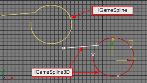

The diagram below shows the relationship of the IGameSpline container object to the IGameSpline3D objects it contains.
