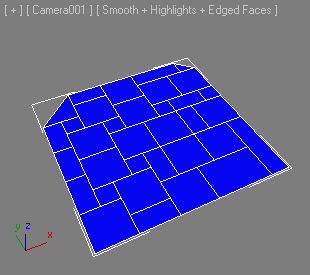

<boolean>PolyToolsTopology.Mosiac ()
Generates a mosaic topology with random bricks of different sizes.
Returns true on success, false on failure.
EXAMPLE:
   --Step 1:
   p = Plane widthsegs:10 lengthsegs:10 wirecolor:blue --create a plane
   convertTo p Editable_Poly --convert to EPoly
   select p --select the plane
   max modify mode --switch to modify panel
   subObjectLevel = 4 --switch to Edge level
   --Step2:
   PolyToolsTopology.Mosiac()

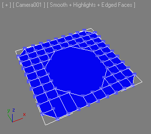

<boolean>PolyToolsTopology.Holer ()
Generates "holes" in the topology. See also .Tatter() further on this page.
EXAMPLE:
   --Step 1:
   --Step 2:
   PolyToolsTopology.Holer()

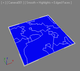

<boolean>PolyToolsTopology.Chaos ()
When applied to a grid of quads, generates a chaotic topology with randomly shaped patches.
EXAMPLE:
   --Step 1:
   --Step 2:
   PolyToolsTopology.Chaos()

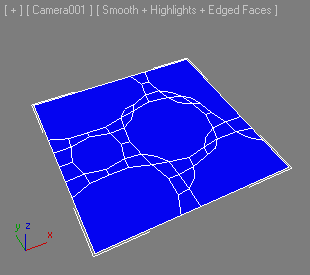

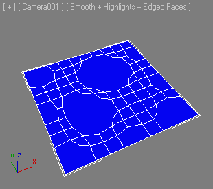

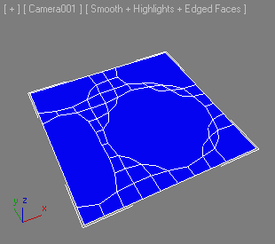

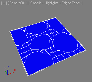

<boolean>PolyToolsTopology.Tatter <integer>size <integer>iterations <integer>smooth
Generates "holes" in the topology, separated by rows of polygons.
The first argument determines the overall size of the generated holes.
The second argument determines the number of different sizes for the generated holes.
The third argument determines how rounded the generated holes will be.
EXAMPLES:
   --Step 1:
   --Step 2:
   PolyToolsTopology.Tatter 1 1 1

   PolyToolsTopology.Tatter 2 1 1

   PolyToolsTopology.Tatter 3 1 1

   PolyToolsTopology.Tatter 1 2 1

   PolyToolsTopology.Tatter 1 10 1
<boolean>PolyToolsTopology.ScrapVerts ()
Removes vertices shared by only two edges.
EXAMPLE:
   --Step 1:
   subObjectLevel = 1 --switch to Edge level
   PolyOp.SetEdgeSelection p #{105} --select one central edge
   for i = 1 to 3 do p.GrowSelection selLevel:#edge --and grow the selection
   p.Remove selLevel:#Edge --then remove the selected edges
   PolyOp.SetEdgeSelection p #{5,8,11} --select a portion of a loop
   p.Remove selLevel:#Edge --and remove it, while leaving some stray vertices
   --Step 2:
