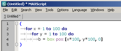

Tabs and Indentation
You can use the TAB key to control the indentation in your script. This makes it easier to read the script and to keep track of opening and closing parentheses used to create blocks of commands.
In contrast to some simpler text editors, selecting multiple lines and pressing TAB will not delete the lines but indent them as a block.
To move the selected line(s) back one tab position, you can press SHIFT+TAB.
If you press the RETURN key to add a new line while inside an indented block in your script, the newly inserted line will respect the indentation and will also use the same number of tabs as the surrounding code lines. If you want the new line to be less indented, you can press the BACKSPACE key one or more times to remove one or more Tabs.
Optionally, you can also display the tabs and other "white spaces" by pressing Ctrl+SHIFT+8 to make it easier to see and correct the formatting.
