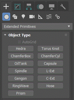

Prism : GeometryClass
Prism - superclass: GeometryClass; super-superclass:node - classID: #(1668308908, 1545557311)
Constructor:
prism... Properties:
