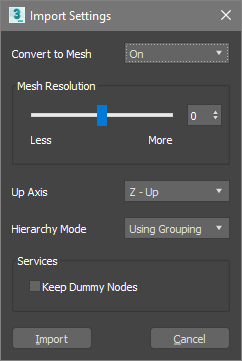

Interface: Import Settings
Properties:
ATF_JT_importer.ConvertToMesh : boolean : Read|Write
Gets/sets the selection of the "Convert to Mesh" drop-down list.
When set to True (default), the imported geometry will be converted to a mesh.
When set to False, the geometry objects will be imported as Body_Object class instances.
ATF_JT_importer.UpAxis : enum : Read|Write
UpAxis enums: {#x|#y|#z}
Gets/sets the selection of the "Up Axis" drop-down list.
Possible values are:
  • #x: X - Up
  • #y: Y - Up
  • #z: Z - Up (default)
ATF_JT_importer.HierarchyMode : enum : Read|Write
HierarchyMode enums: {#UsingGrouping|#UsingLayer|#Flattened}
Gets or sets the selection of the "Hierarchy Mode" drop-down list, which determines how the imported scene is organized by 3ds Max.
  • #UsingGrouping (default) - creates a scene hierarchy using 3ds Max groups
  • #UsingLayer - creates a scene hierarchy using 3ds Max layers
  • #Flattened - creates a flat hierarchy
ATF_JT_importer.MeshResolution : integer : Read|Write
Gets/sets the value of the "Mesh Resolution" slider / value.
Possible values range is from -10 (Less) to 10 (More).
Default is 0.
ATF_JT_importer.KeepDummyNodes : boolean : Read|Write
Gets/sets the state of the "Keep Dummy Nodes" checkbox.
When set to True, dummy nodes will be preserved.
Default is False.

EXAMPLE
   ATF_STEP_importer.ConvertToMesh = false --keep Body Objects
   ATF_STEP_importer.UpAxis = #y --switch axis to Y up
   ATF_STEP_importer.HierarchyMode = #Flattened --flatten hierarchy
   ATF_STEP_importer.KeepDummyNodes = false --no dummies
   importFile @"C:\Temp\mytestfile.jt" #noprompt --import without UI
