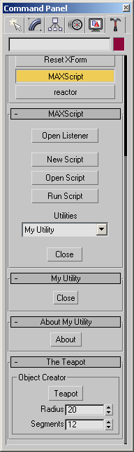

As an example, consider the following script. In this script, line 1 defines the start of the utility, and the utility body is lines 2 through 42. The following line ranges are utility clauses: 3 (a rollout clause), 5 to 9 (a nested rollout), 11 to 30 (a nested rollout), 32 to 35 (a rollout clause), and 37 to 40 (a rollout clause).

The Utilities panel rollouts created by the previous script look like the following:
Multiple rollouts defined in a utility
