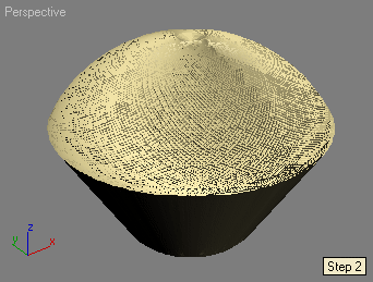

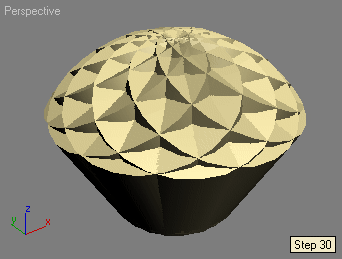

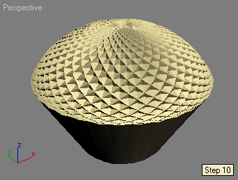

     c = cylinder() --create a cylinder
     c.dir = theRotV --orient along the vector to see what it looks like
The results looks like a muffin!
