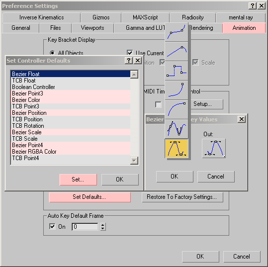

The BezierDefaultParams Structure allows you to set the default Bezier key parameters to be used for newly created Bezier controller keys.
Available in 3ds Max 2008 and higher. Previously available in the free Avguard Extensions.
Properties
BezierDefaultParams.inTangentType BezierDefaultParams.outTangentType
Get/set the default Bezier key in and out Tangent Types.
Valid values are: #smooth | #linear | #step | #fast | #slow | #custom | #flat
