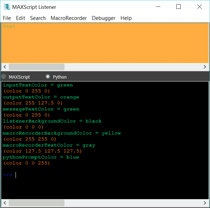

inputTextColor
Lets you get and set a Color value defining the color of typed input text in the Scripting Listener.
messageTextColor
Lets you get and set a Color value defining the color of error message text in the Scripting Listener.
listenerBackgroundColor
Gets or sets the background color of the Scripting Listener. When this value is changed, the caret color changes between black and white as necessary to remain visible. Available in 3ds Max 2020 and higher.

outputTextColor
Lets you get and set a Color value defining the color of output text in the Scripting Listener.
EXAMPLE
