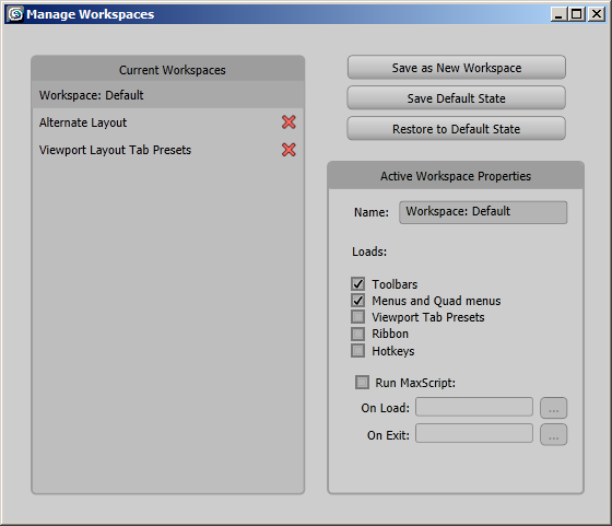

Interface: WorkspaceManager
The WorkspaceManager Core Interface exposes the features of the Manage Workspaces dialog to MAXScript.
