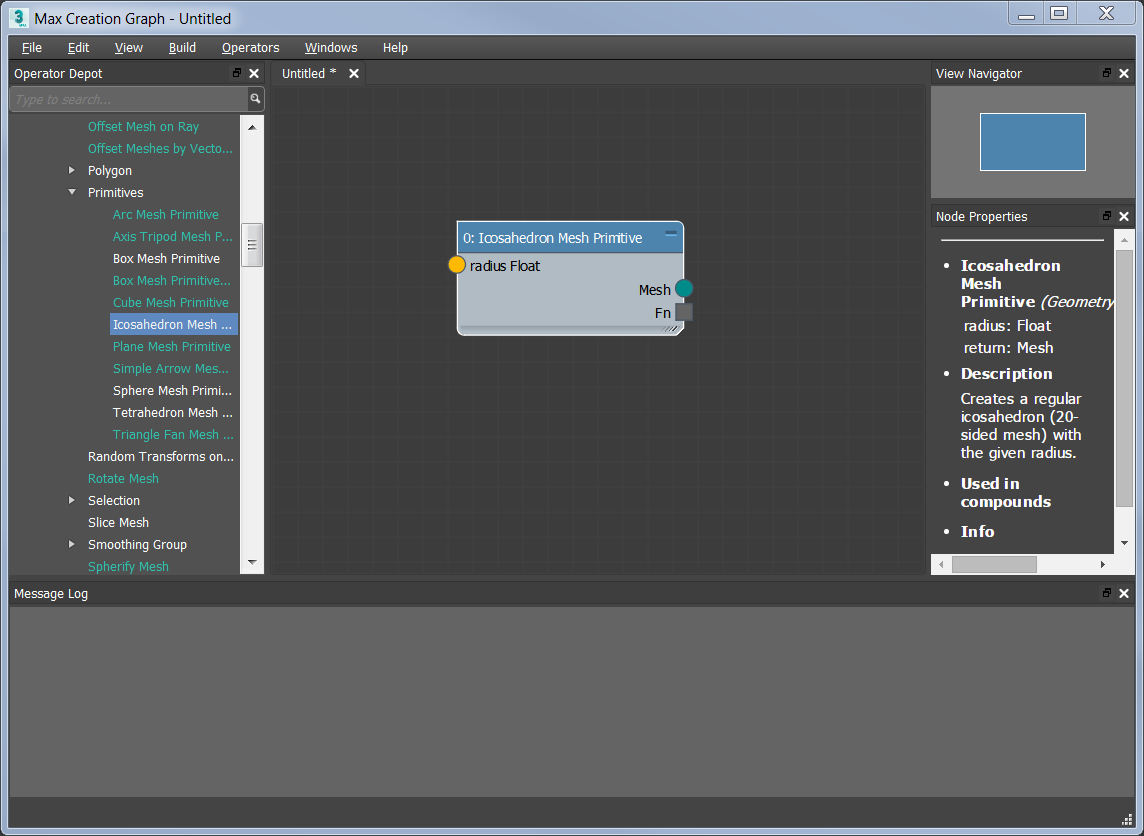

Open the Max Creation Graph Editor (Scripting > New Max Creation Graph). The Max Creation Graph editor consists of a menu bar and five windows: The main graph window, the Operator Depot, the View Navigator, the Node Properties, and the Message Log.
In the Operator Depot, expand Geometry > Mesh > Primitives to view Icosahedron Mesh Primitive. Drag this node into the graph editor window.
This node contains the basic functionality for creating an icosahedron object. Note that it has an input connector on the left side, labeled "radius Float," and on the right side an output connector, labeled "Mesh." (There's also a function output, but we're not going to use it here.)
As indicated by the labels, the node's input requires a floating-point decimal value, and the output requires a node that produces a triangle-based mesh object.

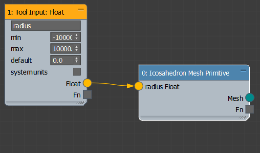

To complete the graph, you'll add and connect a tool input node that lets the user of your graph provide a value for the Radius parameter, and an output node to produce the geometry.

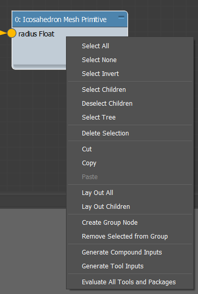

In the graph editor window, right-click the node. At the bottom of the menu that opens, choose Generate Tool Inputs.
A Tool Input: Float node appears in the editor window, already wired to the Icosahedron node's input connector.
