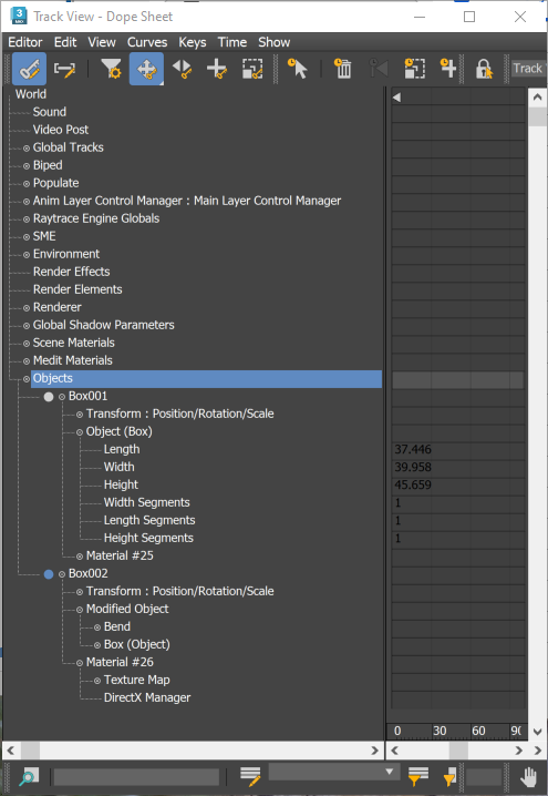

Below is a partial screen capture of Track View that demonstrates some sub-animatables:
A node has six sub-animatables:

If a node does not have some of these assigned (for example the material and visibility controller) these sub-animatables are NULL. Any sub-animatables that are NULL don't appear in Track View.
In the example above, the node Box001 has two sub-animatables that are non-NULL: the transform controller (labeled Transform) and the object reference (labeled Object(Box)). The other node, Box002, has three non-NULL sub-anims. These are the transform controller (Transform), the derived object (Modified``Object), and the Material (Material #25).
Note that sub-animatables may have sub-animatables themselves. This can be seen in the parameters of Box001 sub-animatables Object (Box). Objects derived from SimpleObject (like Object (Box)) have the parameter block as an animatable. The box's parameter block has six sub-animatables (Length, Width, etc.). Note also that the node Box002 sub-animatable Material #26 has sub-animatables of its own. These are its parameters and its texture map.
Sub-animatables are often the animatable parameters of a plug-in. In 3ds Max any animated parameter has a controller to control the animation. The controller for a parameter appears in the track view. This allows the user to view the animation associated with a parameter in several formats such as in key frames, as a range of time over which the animation takes place, and graphically as a function curve.
