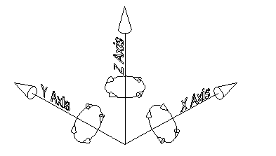

The cells in a rotation matrix are the sines and cosines of the angle of rotation. In the Matrix3
right-handed coordinate system, positive angles move in a counterclockwise direction, when looking down an axis from positive to negative. In the diagram below, the cones along the XYZ axes point in the positive direction, and the cones in the circles around each axis point in the positive direction of rotation.
