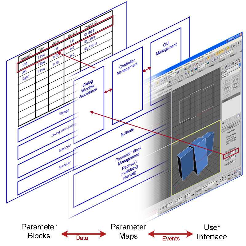

The Relationship between Parameter Blocks and Parameter Maps
Parameter blocks handle the storage of variables, and parameter maps handle events and the UI. The UI communicates to parameter maps and the user interface communicate by methods, window & dialog procedures and other events. Parameter maps ultimately pass data back to the parameter block.
Figure 1
