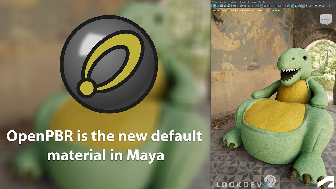

OpenPBR is the new default Material
OpenPBR is now the new default material in Maya. It offers an expressive and intuitive set of controls capable of accurately modeling the majority of CG materials, together with increased interoperability including compatibility with MaterialX and OpenUSD. For detailed information about its usage and settings, see OpenPBR Surface in the Arnold User Guide.
