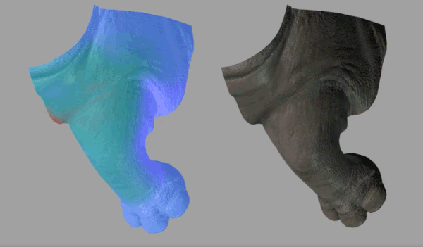

Dynamic Geometry Attributes provide technical artists with advanced per-vertex analysis tools to improve character deformation quality, create procedural effects like animated wrinkles, and easily identify problem areas in their rigs.
dgaTension Node
The dgaTension node measures surface tension by comparing input geometry with reference geometry. It offers Edge and UV calculation methods to detect stretch and squash in deformed meshes. The "ComponentTagExpression" attribute allows processing of specific mesh portions for targeted analysis. Output data can be visualized with the dgaVisualizer node and connected to deformer weight lists for driving corrective deformations.
dgaDelta Node
The dgaDelta node computes positional and normal differences between two mesh states, providing precise delta information for each vertex. This node operates similar to the tension node and its output data can be connected using the dgaVisualizer node to display results and can drive deformers by connecting to a deformer's weight list. The node outputs two values: Position Delta under "Position" Delta Mode, and Normal Delta under "Normal" Delta Mode.
dgaVisualizer Node
The dgaVisualizer node provides real-time visual feedback for Dynamic Geometry Attributes data through customizable color mapping. It converts numerical tension or delta values into intuitive heat map displays on your mesh surface. Use the color ramp and scaling controls to adjust the visualization intensity and clearly identify problem areas in your deformations.
