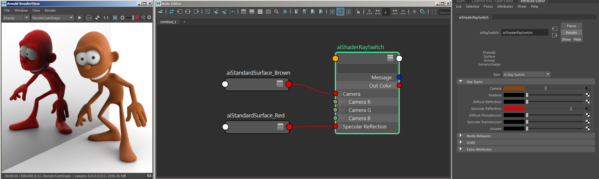

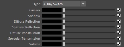

    See Ray Switch Shader in the Arnold User Guide for the full shader documentation.
    This shader makes it possible to evaluate different color trees per ray.
    Note:
    For an example of how the ray_switch shader can be helpful, see the reducing noise (although note that the precise method described there would not be necessary if you use the skydome_light instead of the sky).
    Example use of rayswitch shader
    Pepe model by Daniel M. Lara (Pepeland)
