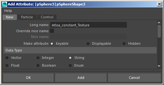

  • Create a sphere and add an extra attribute to the shape node (not the transform node). Use the down key ( pickWalkDown ) to select the shape node.
  • Add the Long name - 'mtoa_constant_Texture' ('Texture' is the prefix that we will use for the Ai User Data String node, but you can call it what you want (do not use 'name', it will not work). Set the 'Data Type' to 'String'.

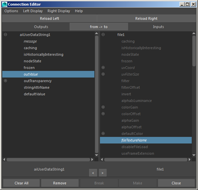

  • Open the connection editor for both of them. Connect the outValue attribute of the Ai User Data String node to the fileTextureName attribute of the 'file texture' node:

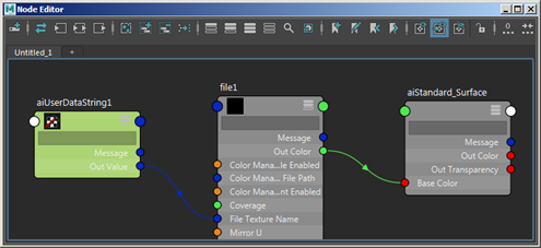

The shader network should look like this:
Ai User Data String connected to file texture node

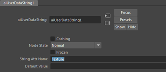

  • Select the Ai User Data String node and type in the prefix that was added to the attribute for the sphere (in this case 'Texture').

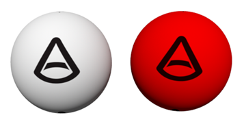

  • Render the scene. The sphere should render using the texture path that was added to the sphere's attribute.
  • Duplicate the sphere. Under 'Extra Attributes' for the second sphere, type the full path name (absolute) of a second texture map.
  • Render the scene. Both spheres are now using the same standard_surface shader but have separate textures assigned to them.
