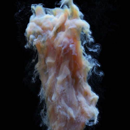

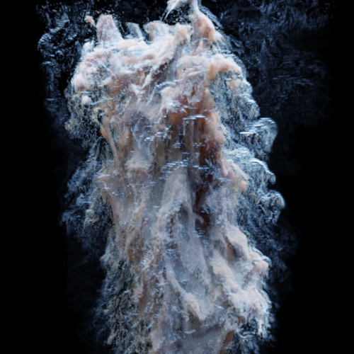

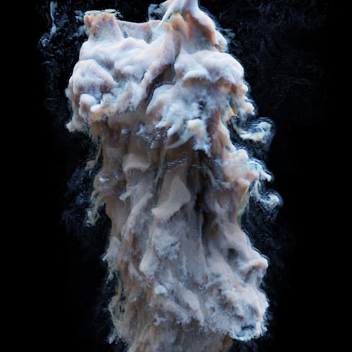

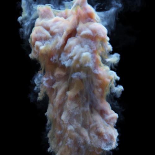

Contrast
1 | 2 | 10 |

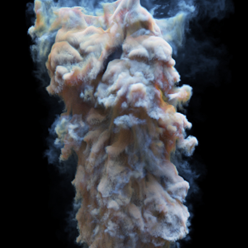

Exposure
0 | 1 | 8 |

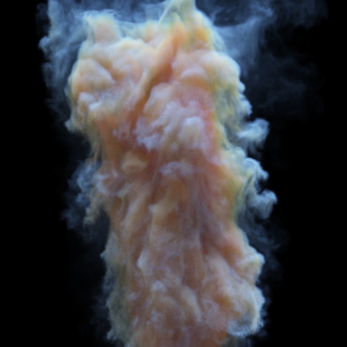

Multiply
1 | 10 | 25 |

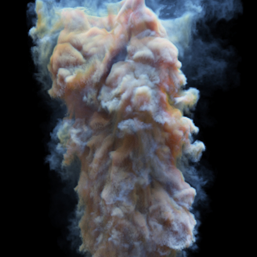

Add
-5 | 0 | 5 |

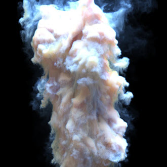

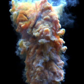

The final corrections used in this example involved adjusting the gamma, exposure, multiply and add attributes as per the image below:
Final attributes for volume_sample_rgb

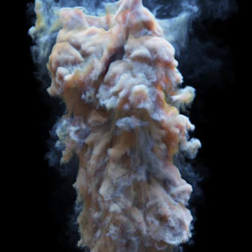

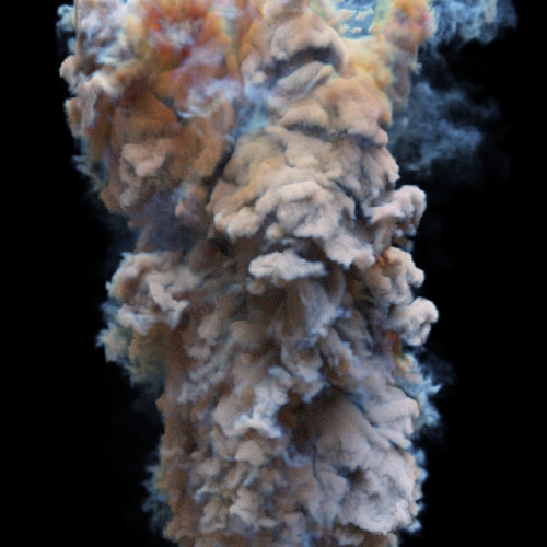

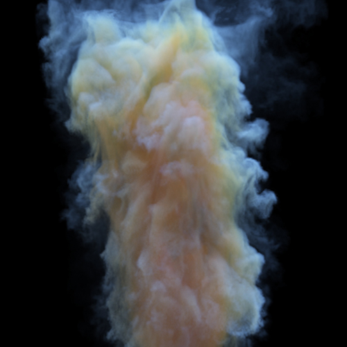

Volume Ray Depth
Increasing the volume_ray_depth can also have a dramatic affect on the appearance of the volume. Remember to increase the number of volume_samples to compensate for any resulting noise. In this example, 6 volume_samples was used.
When increasing the volume_ray_depth, you may need to reduce the exposure of the scene lighting to compensate for the additional multiple scattering of illumination in the volume.
0 | 6 |
