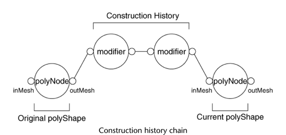

Construction history provides a backlog of actions performed on a mesh. The implementation of construction history in the DG makes it unique. For all objects in Maya, a single linear chain of DG nodes can exist upstream from the object’s node. This chain is known as the construction history of an object. The final node of a history chain always represents the object that the history is recording actions for. At the beginning of the chain lies a hidden intermediate node representing the initial state of the node when the history first began to record actions performed on the mesh.
The manipulation of the mesh can be complicated by the following factors, which affect the state of a node:
  • Whether or not the mesh has construction history
  • Whether or not the user has construction history recording turned on
The presence of construction history indicates that there is a chain of modifier nodes upstream from the mesh node—the history chain. Each modifier node in the history chain is connected via their inMesh/outMesh attributes through which the mesh data flows down the chain. During a DG evaluation, the outMesh at the top of the history chain passes the mesh down to each modifier node, each applying their modification in turn. Once the mesh reaches the actual mesh node and end of the chain, the modified mesh is stored on the node, overwriting any previous data on the node.

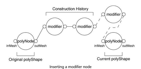

Attempting to modify a mesh node via API mutator methods writes the information directly onto the inMesh attribute of the given mesh node. Although some methods are history sensitive, there are many that are not. This, combined with the DG evaluation process presents the problem if history exists. Since a DG evaluation will overwrite the inMesh of the mesh node due to the connection from the outMesh of the modifier node directly upstream from the mesh, any modifications made to the mesh will be discarded.
The solution to this problem is to create a node that performs the modification want and if history exists, to insert your node directly ahead of your mesh node in the history chain as shown below. The node directly upstream from the mesh node always represents the last change made to the mesh.
Whether the user has construction history turned on or off does not restrict the modification of a node as rigidly as whether the mesh has construction history. However it is a good practice to adhere to the user’s construction history preferences and behave similarly to the rest of Maya. This preference will change how the node should be modified as well as what the node will look like in the DG following the operation.
With history turned on, the user has selected to keep a history chain. Following the operation, the resulting mesh would look like the previous diagram (Inserting a modifier node).
