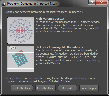

Problems Detected in Imported Mesh
In some cases when you send objects from Maya, Mudbox detects an issue with the mesh. Either of the following warnings can appear when you send the mesh.
- High-valence vertex
- UV Faces Crossing Tile Boundaries
Both of these problems can be corrected in Maya.
To correct a High-valence vertex issue
- Select the object in Maya.
- Open the Attribute Editor and select the History tab for the poly object.
- Change the Subdivisions Axis and Subdivisions Height values to 15.
Note: This problem is often associated with spherical objects.
To correct a UV Faces Crossing Tile Boundaries issue
- Open the UV Texture Editor and select the Move UV Shell tool.
- Reduce the size of the object so that it is not touching the UV shell borders.
