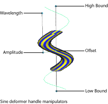

To edit sine deformers by using the handle manipulators
- Select the sine deformer node (default name: sinen).
- Select the Show Manipulator Tool (default shortcut: t key).
- The manipulators on the sine deformer handle let you edit attributes interactively.
- In the scene, select one of the manipulators on the sine deformer handle. Middle-drag the mouse to edit.
The Channel Box updates the values you are changing.
