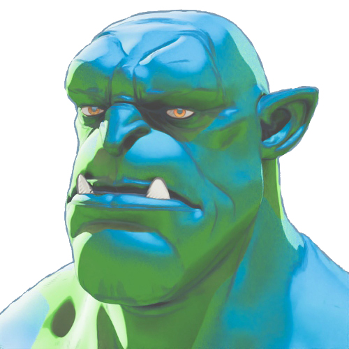

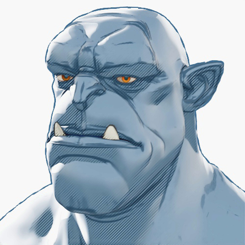

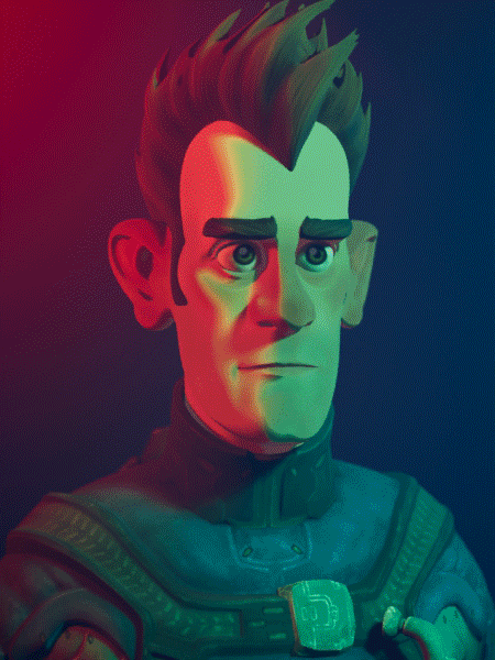

Toon tone-mapping

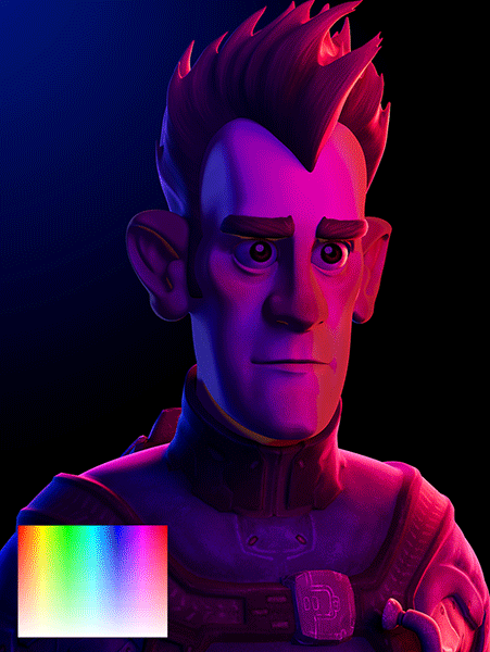

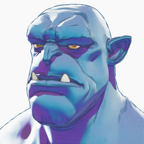

You can now drive the hue and saturation of tonemapping in the toon shader. The toon shader has four new parameters that complement the existing value-based tonemapping parameters. The connected shader's U coordinate drives direct light hue and the V coordinate drives saturation, which enables textures like those below to map the toon shader's response to colored lighting (Note: make sure to set the image's wrapping mode to clamp and filter to closest for best results) (ARNOLD-10687). These toon parameters include:
No base_tonemap_hue_saturation image -> base_tonemap_hue_saturation image -> specular_tonemap_hue_saturation
Color palette images -> base_tonemap_hue_saturation image.offset_u: 0 to 1 (light color is unchanged)

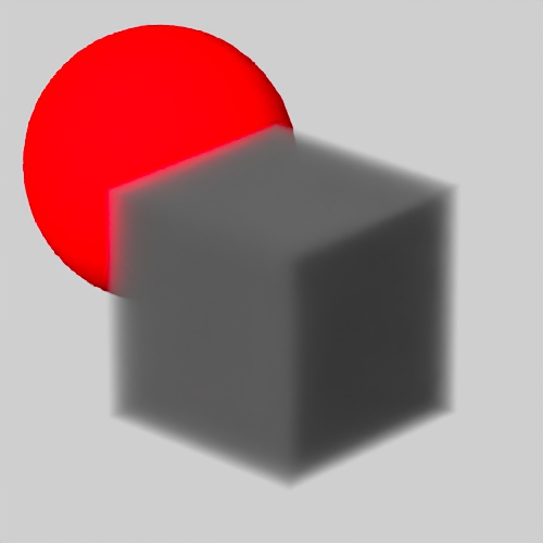

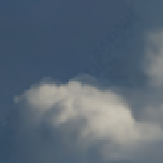

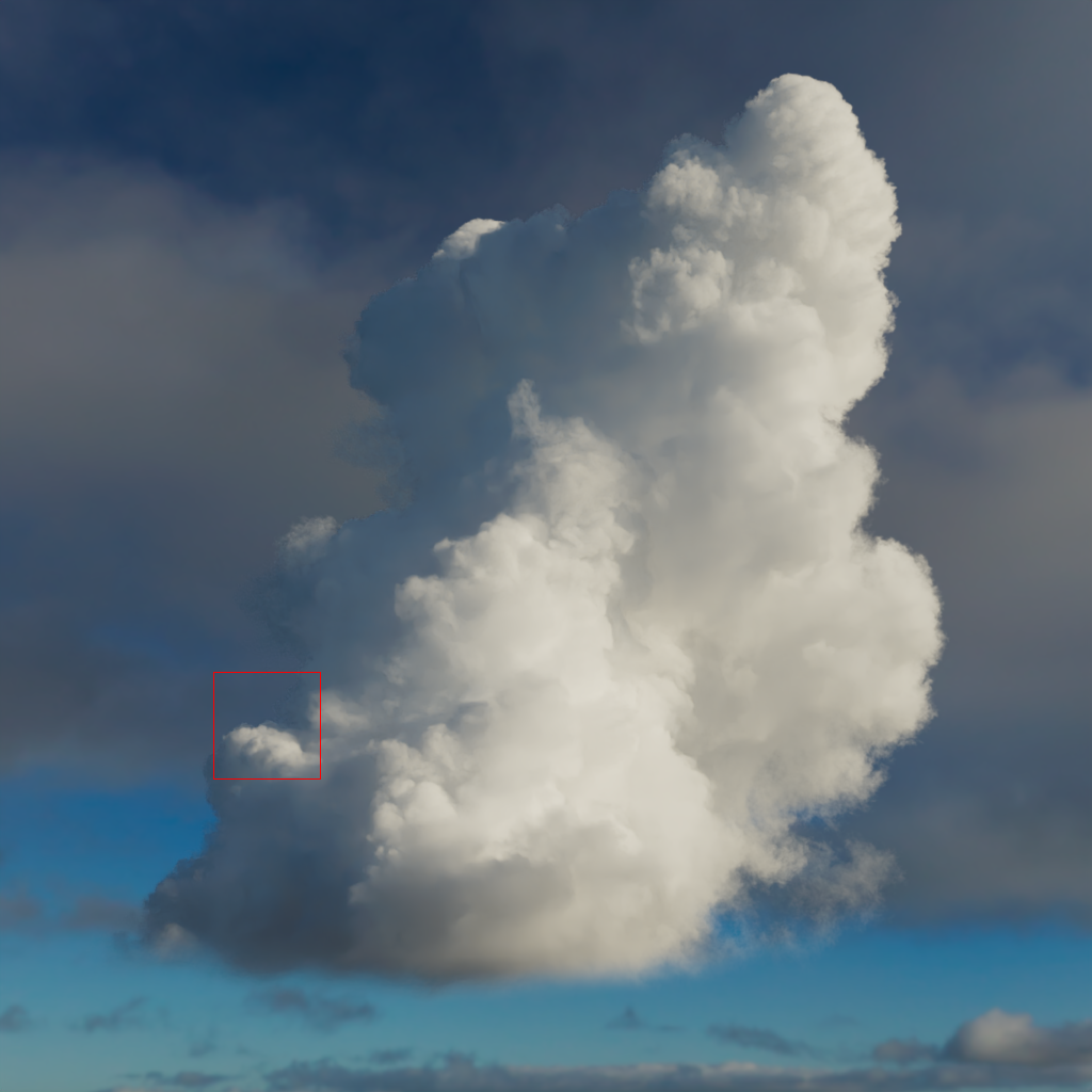

Better volume denoising
Denoising volumes now produces better results. The changes in how volume albedo is computed help the denoiser to keep more details. Ringing artifacts when objects are viewed against the background are also reduced, and a new N_denoise AOV fixes some denoising artifacts visible in low-AA renders. (ARNOLD-14936, ARNOLD-13071)
7.3.1 7.3.2
7.3.1 7.3.2
7.3.1 7.3.2

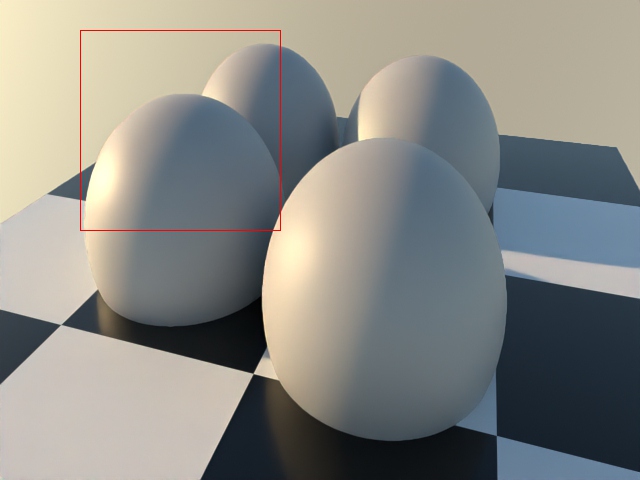

Many-lights support for light linking
Global light sampling is now applied per group of lights linked to a shape. That can improve rendering performance for scenes with light linking. The ALab scene now renders twice as fast when you use Global Light Sampling. (ARNOLD-14985)

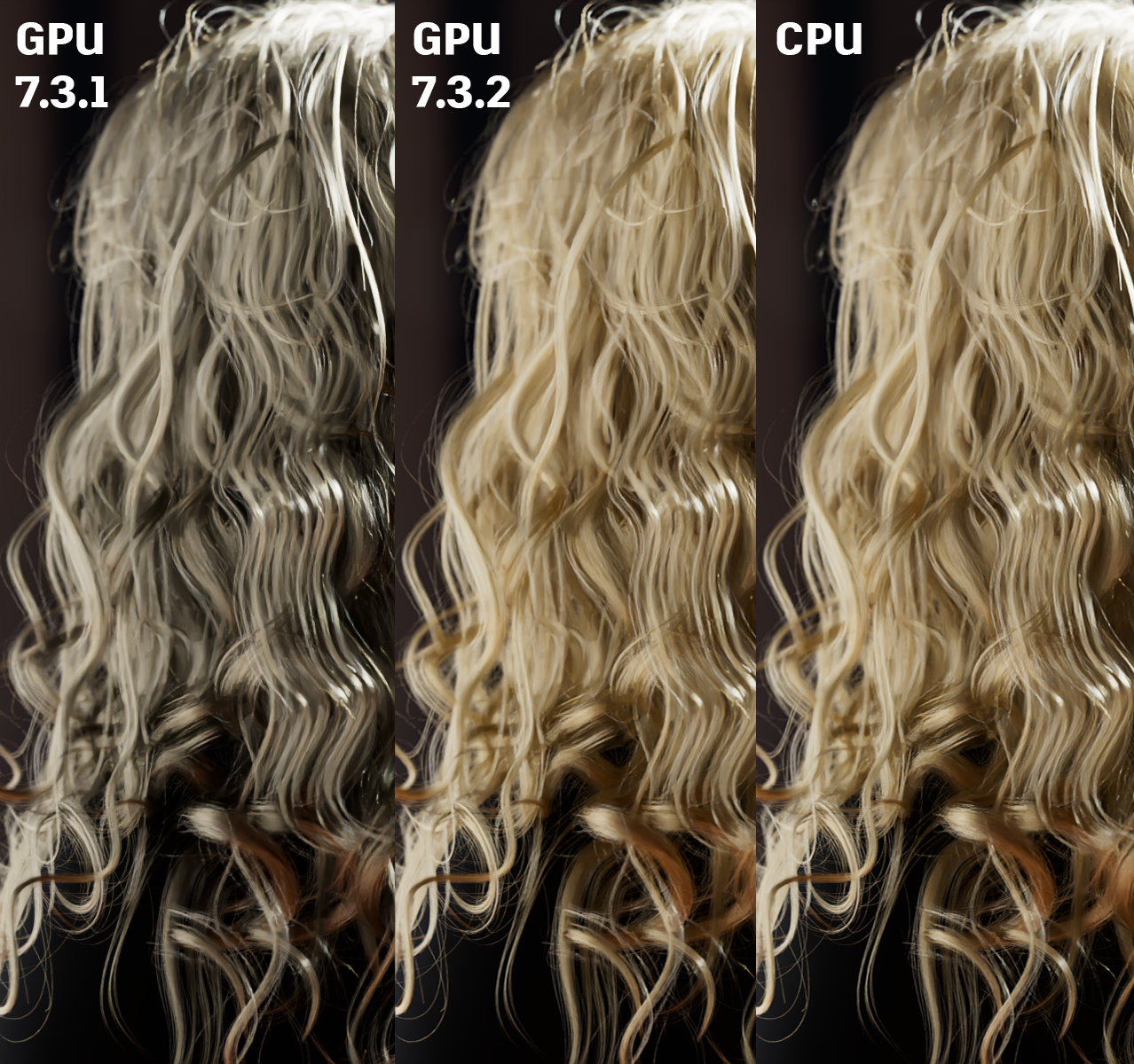

Improved Standard Hair on GPU
The GPU renderer now supports the extra_depth parameter. This enables accurate rendering of blond or bright-colored hair without raising GI_specular_depth.

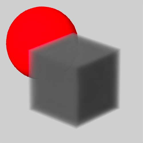

Improved volume albedo AOV
Volume albedo values are now more physically-based. This improves volume denoising and any LPE AOV using volume albedo is now much more useful for compositing. For backwards compatibility, you can set the new global option legacy_volume_albedo to true. (ARNOLD-13071)
