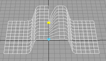

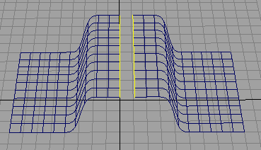

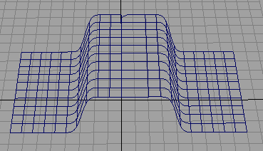

    To stitch surface edges
    1. Select Surfaces > Stitch > Stitch Edges Tool.
    2. Select the edge isoparms on each surface you want to stitch together.
      A temporary stitch surface is created.
    3. You can drag the manipulators to edit the extent of the stitching.
    4. Press to finish the stitch.
