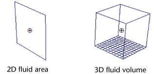

You can create a fluid container and then add an emitter. The emitter is automatically parented to the container so they move together when you move the container.
To create a fluid container with a fluid emitter
- For a 3-dimensional fluid, select >
. For a 2-dimensional fluid, select >
. The Create Container Options window appears.
- Modify options defining the size and resolution of the fluid container, if required.
- Modify the options defining the basic emitter attributes, if required. See Fluid Emitter Options.
- Click Apply and Close.
Maya adds and parents the fluid emitter to the container. By default, Density and Velocity are set to Dynamic Grid with their values set to 0 in each of the voxels. Temperature and Fuel are set to Off.
