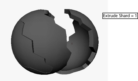

Extrude Shards
Applies to Surface Shatter and Crack Shatter effects. Specifies a thickness for the shards. A positive value pushes the surface outward to create thickness; a negative value pushes the surface inward. You can edit the extrusion amount after you create the shatter, see Change the extrusion value of a shard.
