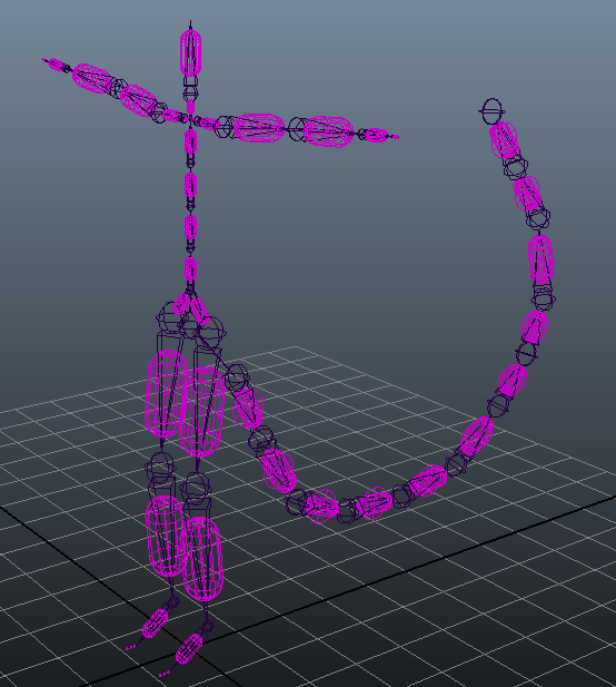

    This tool examines the joint hierarchy starting from the currently selected joint, and creates a capsule around each bone. These capsules follow the animation of the skeleton, and collide with dynamic Bullet objects.

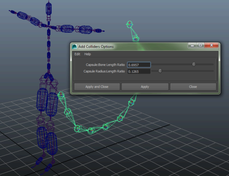

    Note: You can adjust the capsule generation process from theAdd Colliders Options window (Bullet > Add Colliders to Skeleton).
  3. Adjust the following options:
    Capsule:Bone Length Ratio
    Lets you control how much of each bone is covered by a capsule. Reducing this value reduces the amount of overlap between the capsules at the joints.
    Capsule Radius:Length Ratio
    Lets you control the width of the capsules, relative to the length of the bones.
