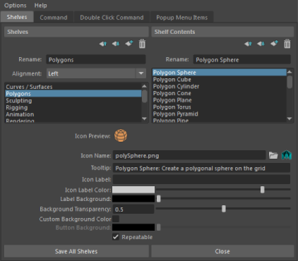

To open the Shelf Editor
- In main menu bar: Windows > Settings/Preferences > Shelf Editor
- Click the gear icon
to the left of the shelves, then select
Shelf Editor from the menu that appears.
- Right-click any item on a shelf, then elect Edit or Edit Popup.
The Shelf Editor lets you create and edit shelves, which are collections of tools and actions that you want grouped together. (See also Shelves.)
| To... | Do this |
| Add a shelf | Select
New Shelf next to the existing shelves.
| Rename a shelf | In the Shelf Editor, Shelves section, select the shelf you want to edit and enter a new name in the Rename text box. |
| Rearrange shelves | In the
Shelf Editor,
Shelves section, select the shelf you want to rearrange and click
| Delete a shelf | In the
Shelf Editor,
Shelves section, select the shelf you want to remove and click
| Navigate among shelves | Use the
gear menu to the left of the shelves to navigate to the previous or next shelf; or, to jump directly to another shelf.
| Add a tool, action, menu item, or script to a shelf | Middle-drag menu items or snippets of code onto the shelf. See Add a tool, action, menu item, or script to a shelf. |
| Show or hide the tabs to streamline your interface | Click the
Shelf Tabs entry in the
gear menu to the left of the shelves to toggle the display of the Shelf Tabs.
