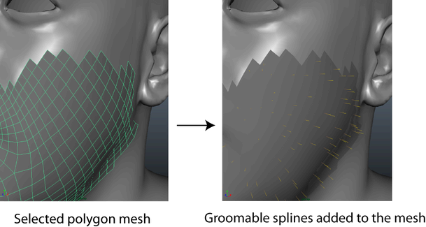

  1. Select the character mesh or faces of the mesh you want create hair or fur on.
  2. From the Modeling menu set, select Generate > Create Description.
  3. In the Create XGen Description window, type a New Description Name and Collection name.
    XGen Descriptions store settings for positioning, generating, and controlling the splines. For more information about Descriptions, see XGen Descriptions.
    A Collection provides a way of organizing Descriptions and the associated files your Description uses. For more about Collections, see XGen Collections.
  4. Set What kind of Primitives are made by this Description? to Groomable splines.
    All other options in the Create XGen Description are automatically set.
  5. Click Create.
    XGen creates a new Description and adds groomable splines to the selected surface.
