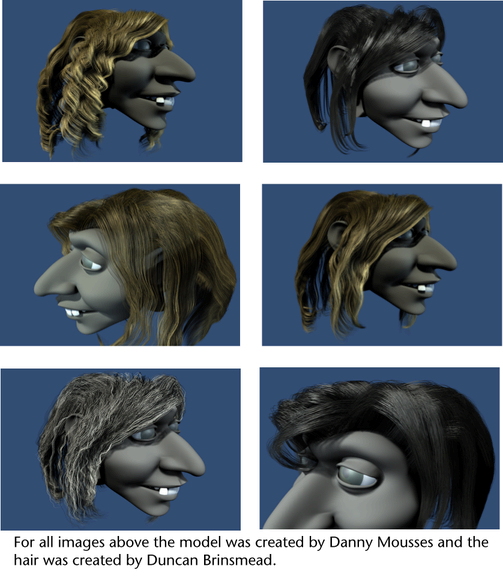

With nHair you can simulate:
  • natural movement and collisions of long hair
  • hair blowing in the wind or being blow dried
  • hair when swimming underwater
  • various hairstyles, including ponytails, braids, and updos
  • collisions between hair and character clothing
  • other dynamic curve effects such as ropes, chains, cables, wires, a suspension bridge, sea creatures, or even a lofted surface from a curve. For more information, see Creating other models and effects with hair.
