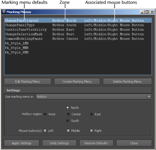

To open the Marking Menu Editor, select Windows > Settings/Preferences > Marking Menu Editor.
Use this editor to edit the available marking menus. Once you define a marking menu, you must assign it to a hotkey or add it to the hotbox before you can use it.
Create Marking Menu/Edit Marking Menu
In this dialog box, you can set the menu name and test your marking menu. To edit items within a marking menu, right-click on a marking menu icon and select Edit Menu Item.
Marking menu item editor
This editor appears when you edit a marking menu item.

Settings
Use Marking Menu in
Specify whether the marking menu is linked to the Hotbox or a hotkey.
Hotbox Region
If you selected Hotbox for Use Marking Menu in, select the Hotbox zone the marking menu occupies: North, South, East, West, or Center.
Mouse Button(s)
Select the left, middle, or right mouse button used to display the marking menu. You can select one, two, or three mouse buttons.
Assign menu to hotkey in the Hotkey Editor
If you want to assign the marking menu to a hotkey, you will configure the hotkey in the Hotkey Editor. To open the Hotkey Editor, select Windows > Settings/Preferences > Hotkey Editor.
