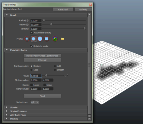

  2. Select Bullet > Paint Soft Body Vertex Properties and select the property to be painted.
    The Maya Paint Attributes Tool settings window opens, allowing you to use all of its painting modes and options. If the Paint Attributes settings are not initially visible, select Window > Settings/Preferences > Tool Settings.
    To see the weights in the Maya viewport, you need to select Shading > Smooth shade All or Shading > Wireframe On Shaded from the Maya’s Panel menu.
