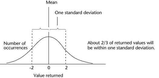

If you were to execute gauss(5) repeatedly and chart the values returned, they would occur roughly with this frequency:
If you were to execute gauss(2) repeatedly, return values would occur with this frequency:
