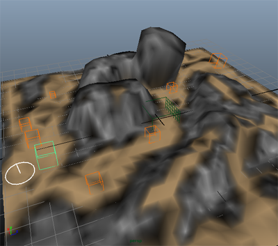

    The mesh is now bound to the Description. Use the Add or Move Guides tool to place the guides on the mesh surface.
  6. In XGen toolbar, click this icon to select the Add or Move Guides tool.
  7. Click areas on the mesh to place the guides.
    The guides for archive primitives display on the mesh as orange cubes. You can now specify which archived geometry you want to instance on the mesh.
