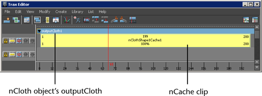

In the Trax Editor, nCache nodes are represented by nCache clips. With these cache clips, you can clearly view the relationships between your nCaches and edit your cached simulations in a nonlinear manner. This allows you to visually manage, manipulate, and direct all your objects’ caches at the same time.
To view nCache clips
- Before you can view your object’s cache clips, you first need to cache your object’s simulation. See Create or import nCaches.
- In the scene view, select the Nucleus or fluid object for which you want to view cached clips.
- Open the Trax Editor (Window > Animation Editors > Trax Editor).
- In the Trax Editor menu bar, select List > Load Selected Characters.
All the selected object’s cache nodes are loaded into the Trax Editor as cache clips. Each clip is placed on its own track, and all your object’s cache clips are grouped under your object’s cache label: outputCloth for nCloth caches, nParticleShape for nParticle caches, and fluidShape for fluid caches.
To select your object from Trax
- In the Trax Editor, select the nCache clip for the object you want to select in your scene.
- In the track view,
-click the cache clip and choose Select Geometry from the context-sensitive menu that appears. The cache clip’s object is now selected in your scene.

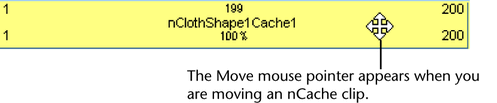

To move nCache clips
- In the scene view, select the object whose cache clip you want to move.
- In the Trax Editor, select List > Load Selected Characters.
All the current object’s caches appear as clips in the track view.
- Do the following:
- To move your nCache clip forward or backward in time, drag the cache clip from side to side.
- To move your nCache clip to a different track, drag the cache clip upward or downward.

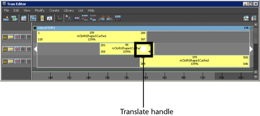

To move multiple nCache clips in time
- In the scene view, select the object whose cache clips you want to move.
the cache clips you want to move. The translate handle appears.
- Drag the translate handle to the left or right to move all the selected cache clips at the same time.
The selected cache clips move forward or backward in time, changing their Start Frame values.

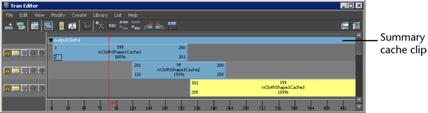

To move all of an object's nCache clips in time
All the current objects’s caches appear as clips in the track view.
- Drag the object’s summary cache clip to the left or right.
All your object’s cache clips move forward or backward in time, changing the Start Frame of all your object’s cache clips.
